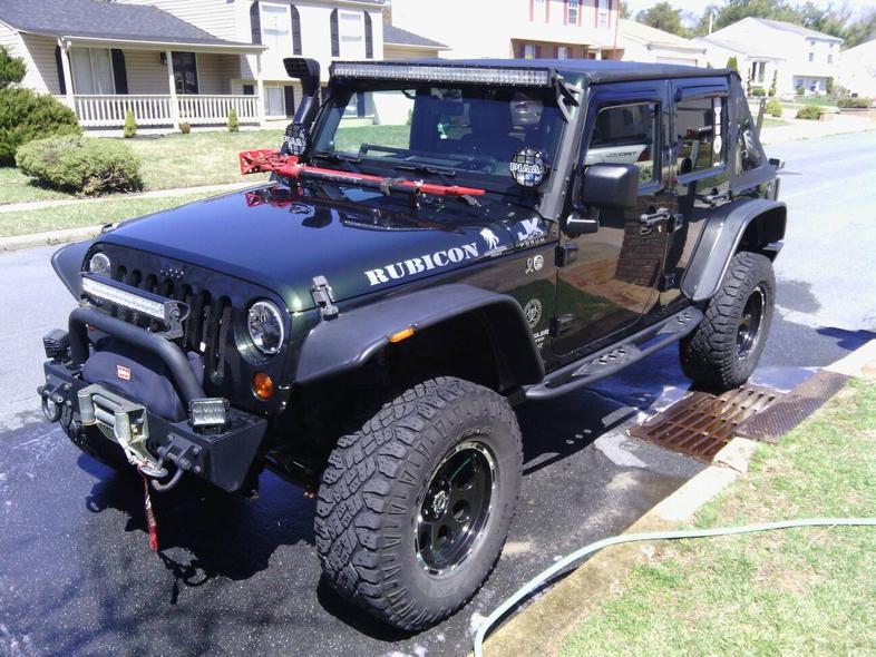

Get some Rubi rail takeoffs and u can either leave them as is, addClick image for larger version
ID:	547281 PSC weld on steps, as I did, or add ACE (bolt on) sliders to them
