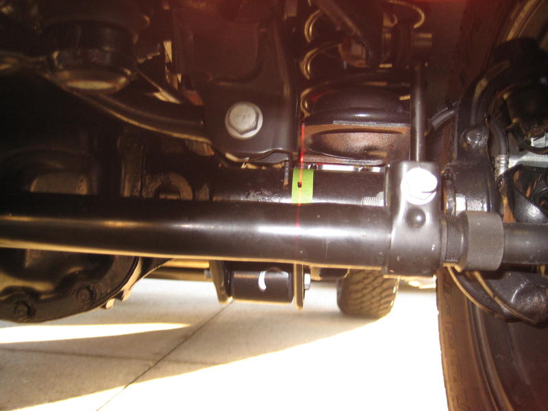

Originally Posted by smittycm
Thanks for clarifying. I'll correct my post in case someone doesn't read all the way through the thread. Don't want to pass misinformation. Good point about both axles possibly being off. More reason to measure each axle independently from a fixed point on the Jeep (e.g. frame).
I agree 100% to use the frame to measure. I thought in advance when installing my lift to use a laser to make center from the factory and then adjust back to that point. I also took many, many measurements from the frame.
