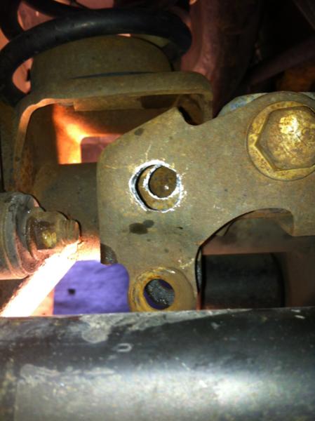

I bought the Rancho stabilizer and kit, the instructions say to increase the hole above the original mount on the track bar bracket. Due to me being an idiot I increased the size too much. The included bolt from Rancho is about a 1" diameter while the hole is about 1 1/2". I have tightened it down extremely tight and there is no play for now... But im afraid later down the road I'm just going to do damage. Solution? Can I weld washers to the hole to have a more secure fit or another option? So embarrassed

Yeh, the welder will be your friend. Find a shop that does fabricating, show them what you've got. Should be able to fix it up fine.

Oh man you are screwed now.........just messing with you!
Yes, you could weld some washers on there or use a bushing.

Yep x2 on the bushing go to your local hardware store.

WOW!! That's HUGE!!!! Don't worry - easy to fix and we all (well not me!) have done something stupid like that!
