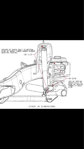

Old May 9, 2014 | 08:24 AM
JKBud's Avatar
Joined: Feb 2013
Posts: 298
From: Essex County, NJ
This should help you figure out what size lift you got. Measure and do the math. Then you can figure out what size bump stops to run to prevent damage to your shocks as mentioned above.
