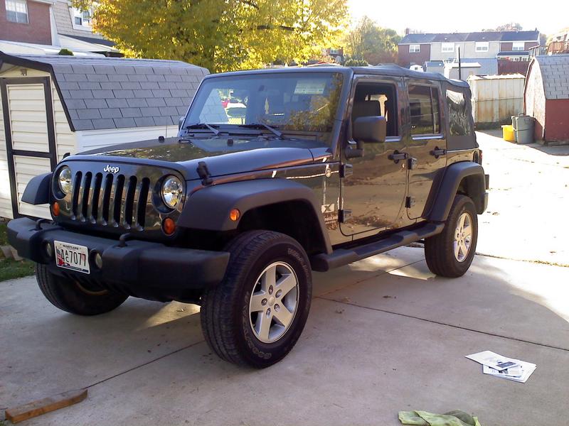

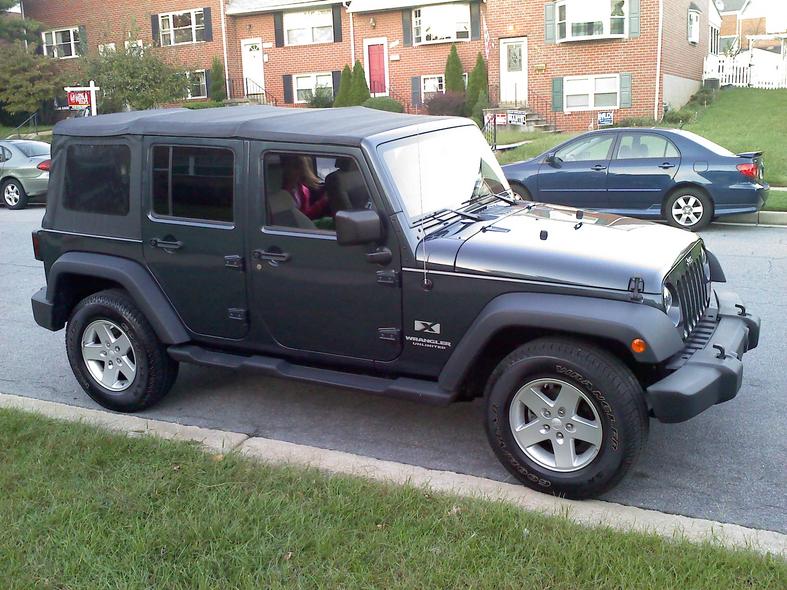

Dozerdriver's Avatar
Posts: 143
From: Halethorpe MD
Originally Posted by Roos85
Could you throw some pics up of your ride? I would love to see what it looks like with that lift on it... Was it easy to install?
This is a before and after...it was a easy lift to install but time consuming. My wife even helped

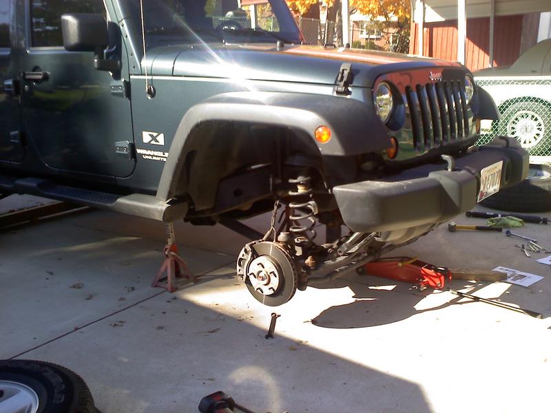

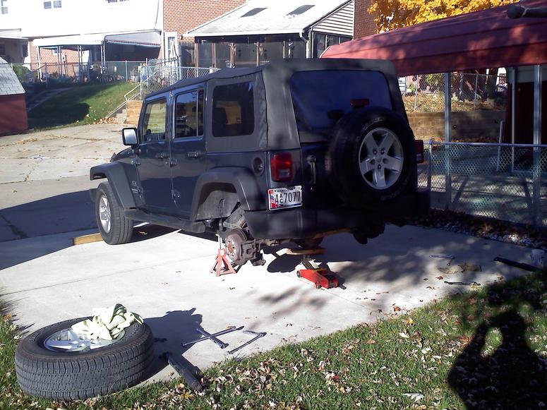

Old Nov 16, 2010 | 10:18 PM
Posts: 143
From: Halethorpe MD
A couple more pics..I am a back yard mechanic in my neighbors yard.
