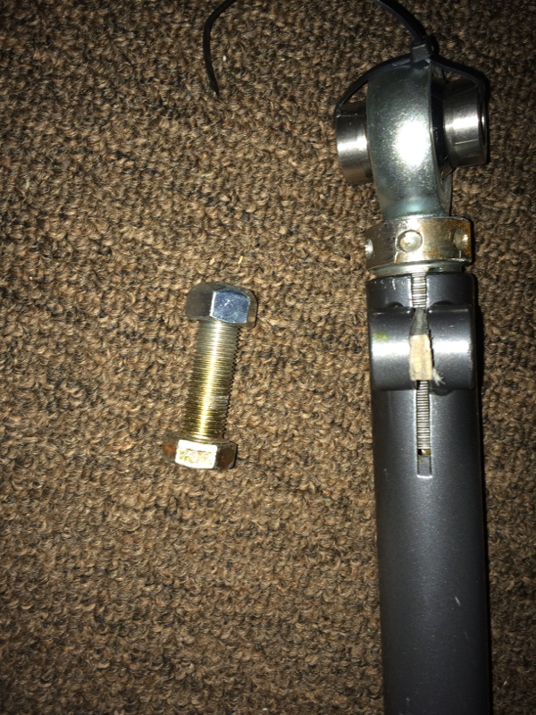

Synergy suggests using a 1/4" punch, that will probably work with the Icon bar. If it's as tight as you say take the end joint and adjuster apart and clean all the threads. Lube with anti-seize and reassemble. Should adjust easily.
Old Oct 24, 2015 | 03:41 AM
kjeeper10's Avatar
Vet Army
Posts: 3,440
From: CT
X2
I took my Synergy bar off, disassembled the adjuster, cleaned everything up and it was still tough to adjust. I ended up taking a wooden wedge and banging it in between the clamps. This made it easily adjustable by hand.
I sold the bar but told the new owner to keep the wedge in place until the axle was centered.
