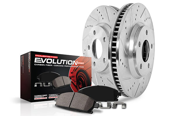

I'm looking at PowerStop rotors and pads on Amazon right now as referred by one of the members! Really like the drilled hole and slotted look plus they have nothing but good reviews!

Worst pads I've ever run in my life. Squishy pedal and brake fade. Oh yeah the metal backing came off both sides causing some nasty squeaking. The rotors are ok though I guess

I have been running PowerStop on my jeep for 3 years, best stopping and longest last setup I have had on a Jeep. I liked them so much I upgrade are other vehicles.

I think some replies are missing this. Teraflex and Dynatrac need at least 17", correct? As does the Mopar big brake. So you are left with stock size rotor upgrades like powerstop, or just better pads?
