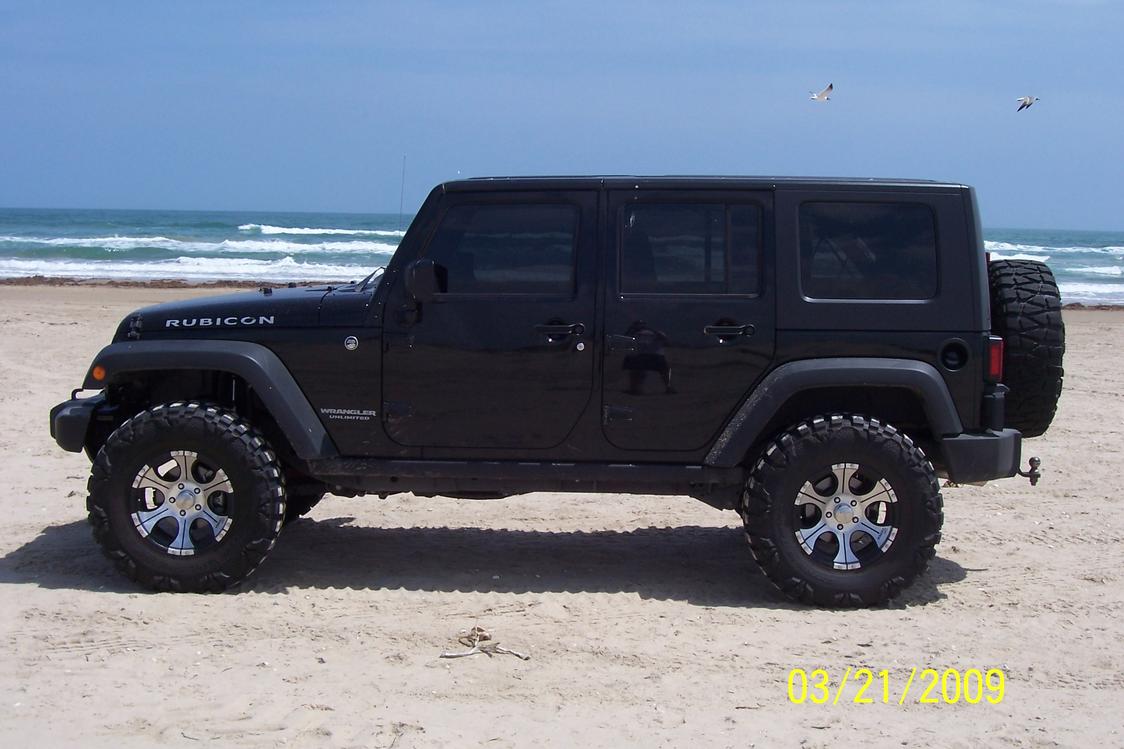

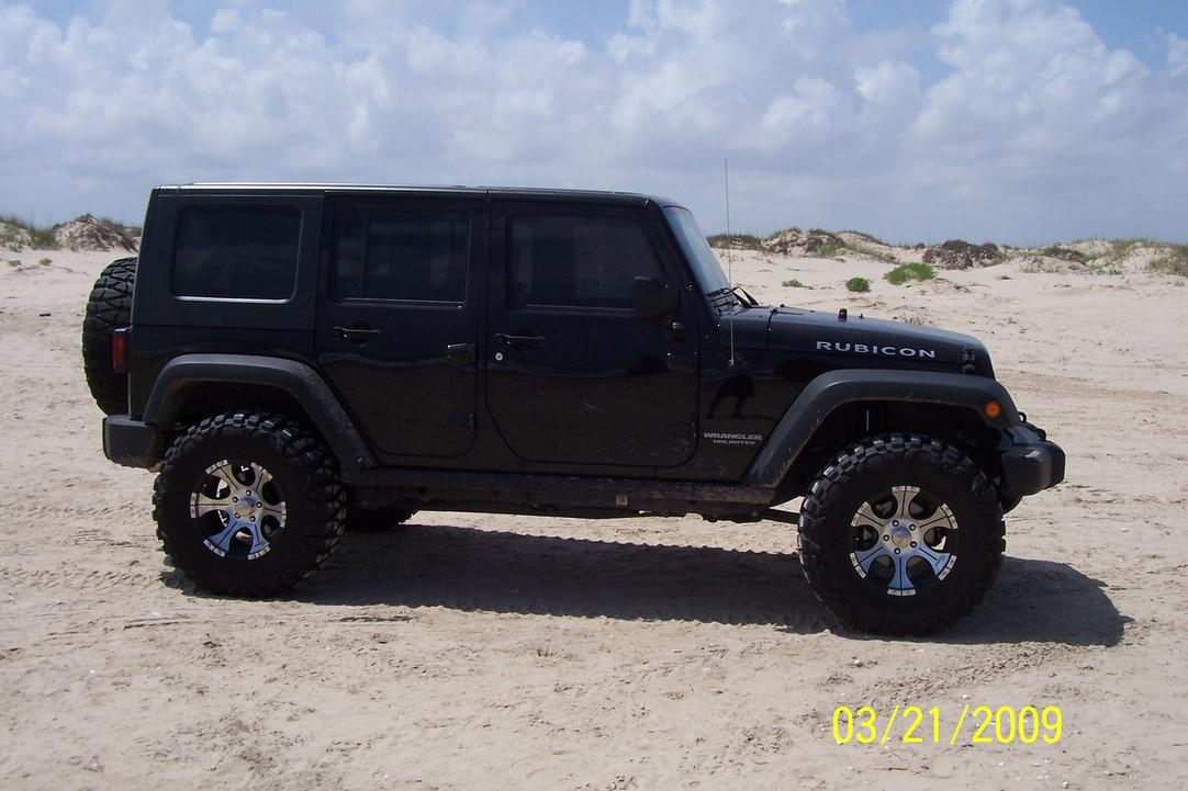

anyways, back to your question. i have a 4 door rubicon that is my DD. the most offroading it gets is some sand at the beach. i went with a teraflex 2.5 inch coil lift with shocks. the ride is great, maybe even better. i also went ahead and put front and rear adj. track bars (not needed with 2.5"). as for tires, i fit my 35" mud glappers under there with no problem (just shave down the dumb factory skidplate alittle). i also put on a RR XHD winch bumper and skidplate, looks nice.
here is a pic of my ride, minus the new bumper. hope you like, and gooooo AGGIES.... WHOOP

Oh man! I'm drooling! That is one good lookin' Jeep! And dang right I'm an Aggie! May '08! Thanks for all the info and the killer pics!
