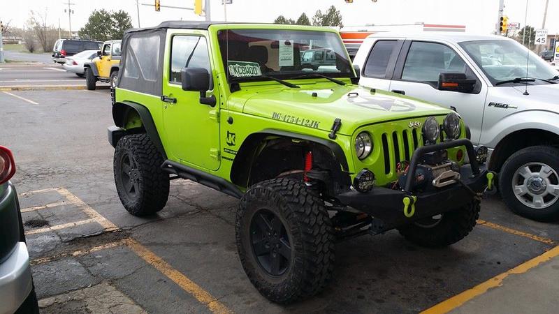

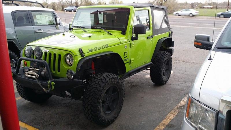

So I have my new lift on with my new fender flares. Lifted up 5" with the skyjacker lift and loving it. Also got new front and rear drive shafts.
I am going to bed line the inside of the fender flares so they look a little better. Also getting upper rear adjustable control arms and have thought about the front lower adjustable control arms as well.
Any thoughts? Suggestions on other things to do it? Im starting to run outta things lol

Do you have any adjustable control arms right now?

What parts came in the kit? For a two door at that height, having all four sets of arms would be good for pushing the axles out. Depending on your usage and tire size, front axle re-inforcement and alloy shafts might be a good call. You could look into a flip/high steer also if you have nothing else to spend money on.

I'd go with front lowers first. How's the ride? Have you strengthened the front axle at all? Drag-link flip, new ball joints, driveshafts...lots to do.

Looks like you could use some more tire, too.
