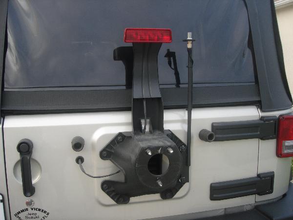

I used a CB antenna mount from Arizona Rocky road. Works perfectly with my Rigid light. I did add a cross bar because it does shake a bit.

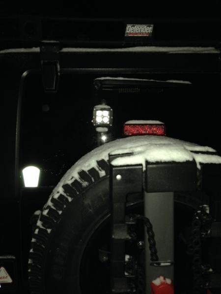

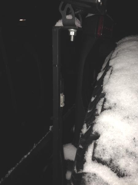

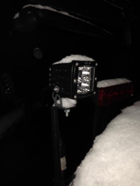

Took a few pics

What bracket did you use? Is this something you fab'ed up yourself? Looks good.
