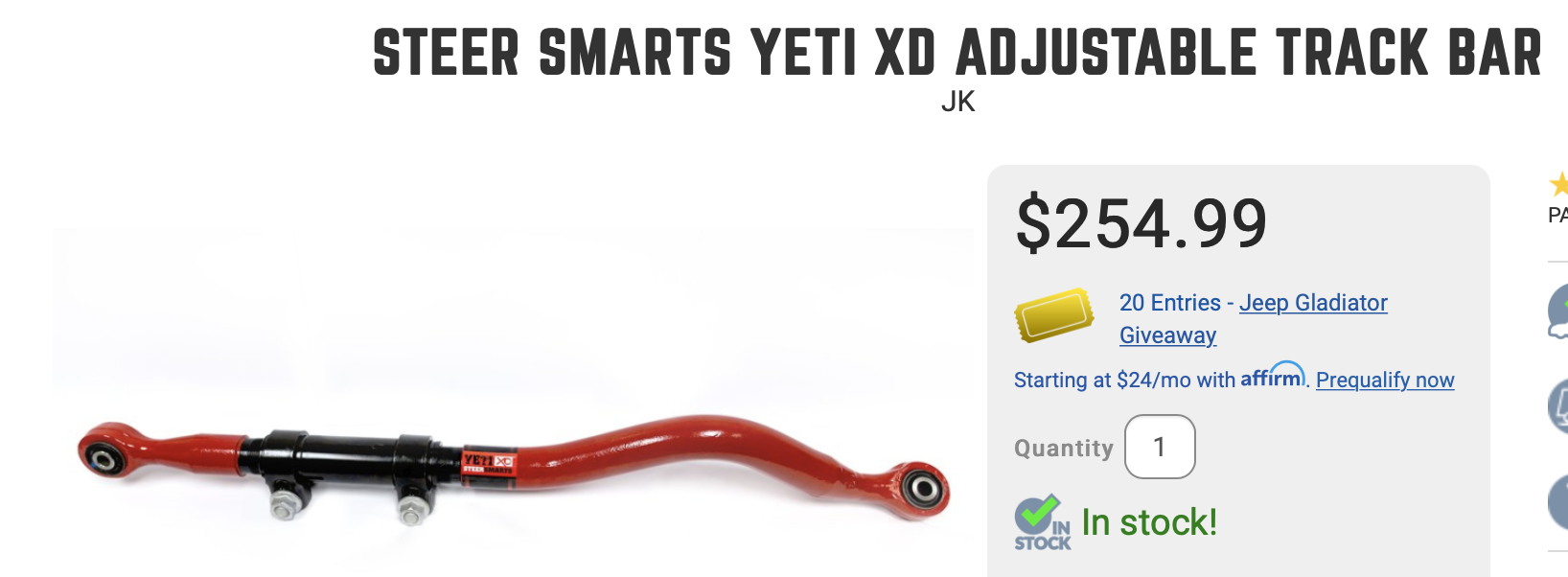

Awesome post, really appreciate the detail. One question, when you say regarding the track bar to "stick with a bushing for that application", is the track bar below okay?

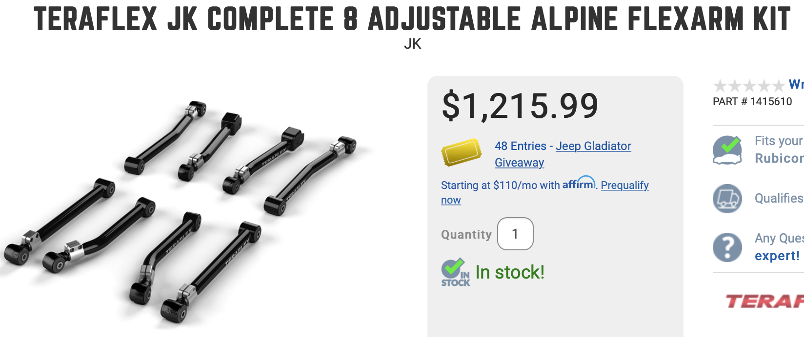

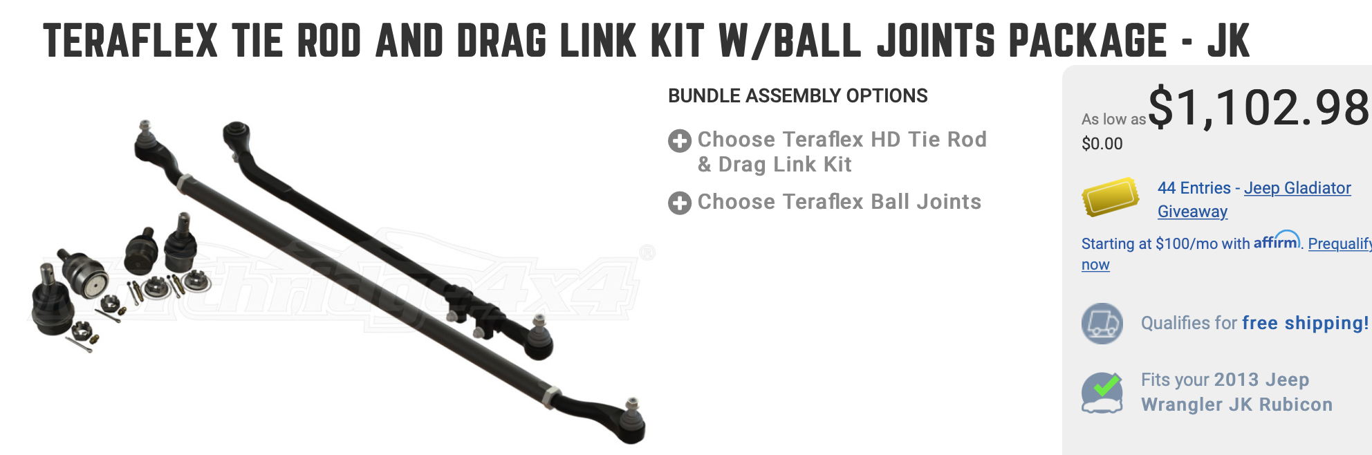

Here's what I came up with based on your info. Seems like a great place to start assuming everything I picked out is adequate.

There is nothing “wrong” with your front TB so to speak, but when the jeep is lifted the front axle will shift to the driver’s side unless the TB is extended longer. (fixed points of attachment on axle and frame and a fixed length bar). An adjustable TB will allow you to get that axle centered under the jeep. This isn’t the end of the world, but you are probably shifted .5” or so to the driver’s side.

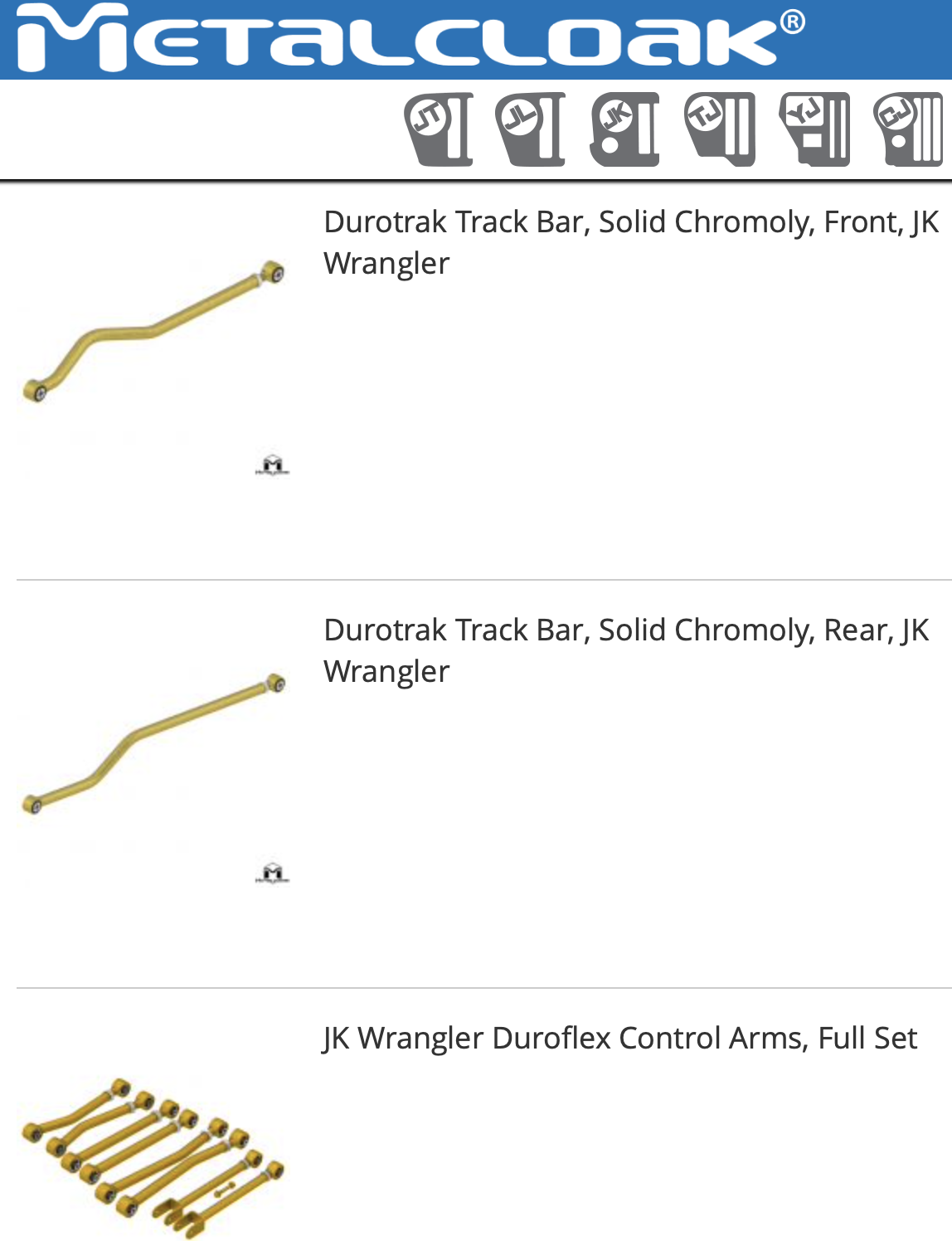

You can do worse than Teraflex, but you also won’t find many of us suggesting their items. My preference is Metalcloak, and you should spend a little time on their website looking at their material. Here is their TB –
https://metalcloak.com/durotrak-trac...-wrangler.html
Many new to the jeep game are not familiar with MC as you don’t see their things at most retailers. You’d buy direct from them. They make great products. You can decide if you buy into their marketing material or not.
Synergy is another great TB, but overpriced IMO –
They pump their “adjustable while installed” double-barrel feature which they charge a premium for if you ask me.
A lot of people like SteerSmarts. I’ve always thought a bit pricey, but I have no first hand experience with em.
As far as ball joints go, this is one area I'd say maybe TF has the best mid-range product. There's a big jump from the $200-250 options up to $500-600. If you do end up with a bad BJ, there is no sense replacing with another factory, Moog, or similar OE equivalent. This is what is inside those factory BJs -

Hey guys thanks again for the tips and advice. Your comments pointed me in the right direction, and after watching countless YouTube suspension videos I believe I have a rudimentary understanding of where to go.
I'm going to start by replacing all 8 control arms and both front and back TB's with Metalcloak components.

It will be nice for you to have a full set of arms and be able to gain some wheelbase back. The front is very straightforward. When you push the rear axle back out and get the pinion pointing at the TC, you might notice your rear springs will have a nice banana bend in em as the perches on the axle don’t line up well with the top. This is common. Some folks will use a little correction wedge on the axle perch to help position the coil. That helps a tiny bit. Some will cut off the axle side perches and use a bolt-on perch they can position, and if you can weld/fabricate there are a few options as well. Just keep this in mind.
Also, when you move the axle back, sometimes the sway bar links lean a bit forward….sometimes enough that they tap the upper control arm mount (axle side sway bar mount is moving back while upper sway bar mount is staying put. If you run into this situation you can relocate the sway bar mounts on the frame back an inch. They make little blocks for this, or you can drill and tap some new holes in the frame rail. Sometimes this can start getting REALLY close to that big factory muffler.
When you install the rear TB on the frame side, don’t push the bolt through like you typically would. As you sit behind the jeep, reach around and insert the bolt through the bracket and towards you. This orientation will give you a little more clearance. If you put the bolt in the other way sometimes the extra threads hanging out can hit the bump stop pad on the axle when the passenger rear is stuffed.
Anyhow, not saying you will certainly run into those issues, but keep them in mind if you do.
Here’s another tip…..it is helpful to have the 2 proper sizes of crows foot wrenches for the jam nuts on the MC arms. I believe I bought mine on eBay and can’t search back that many years in my history to tell you the sizes. You might ping MC and ask what size the jam nuts are. Once the arms are under the jeep the proper crows foot on a torque wrench gets you perfect access. The nuts on the front upper, specially the passenger side, can be a little cumbersome to get to…..but maybe my tranny side just gets in the way on mine. In a real pinch, Harbor Freight sells a monster 2’ crescent wrench for ~$20, and that is big enough to get on those jam nuts as well. The nuts are too big for the standard 14” crescent most people have.
