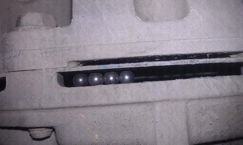

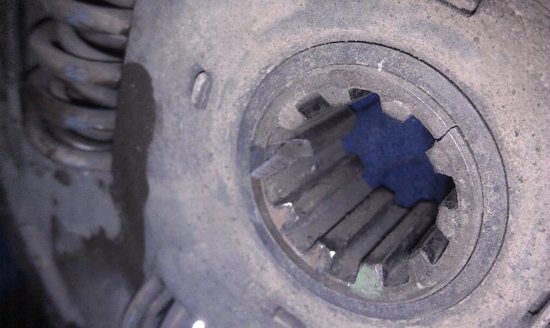

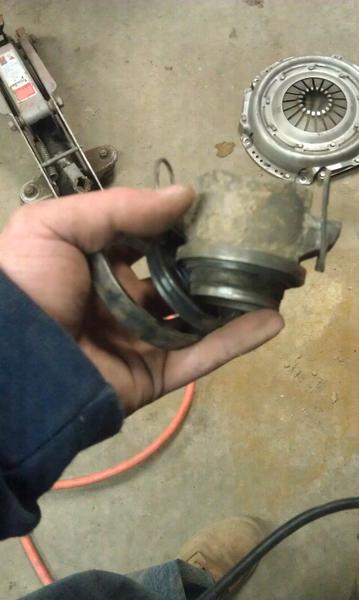

Clutch, throw out bearing, pressure plate. Been there done that. This was what my throw out bearing looked like when I pulled it out
Broken clutch shaft
This is the bearings out of the throw out bearing in the bottom of of the tranny vent
