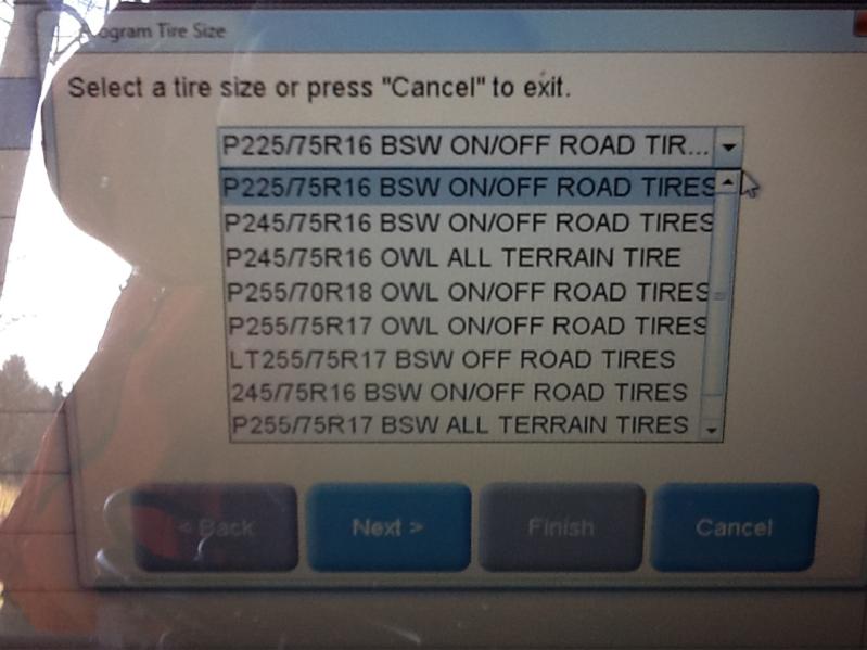

Here's a screen shot of the sizes the dealer can program...it is probably cheaper to buy an aftermarket programmer and do it yourself..
ID:	251249   Click image for larger version
