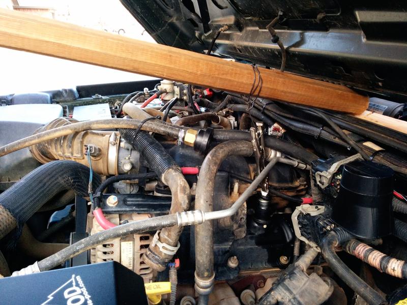

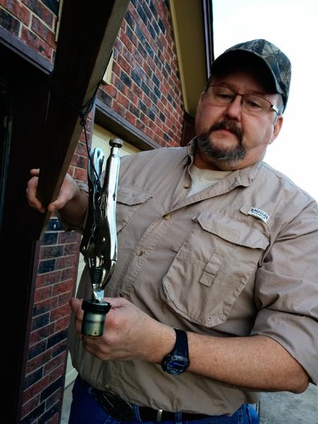

Where were you the other day when I was pulling the PCV valve out of my Jeep?
Name:	Jeep PCV Valve Swap, Feb 14, N5_1715, The Rig.jpg
Name:	Jeep PCV Valve Swap, Feb 14, N5_1757, Wylie and The Rig.jpg
It took all of that, plus heat!, to get that PCV valve out. And the fellow pictured was the fourth person to give it a go, and he's 6"4" and 275 pounds of muscle. And we still had to add the heat!
