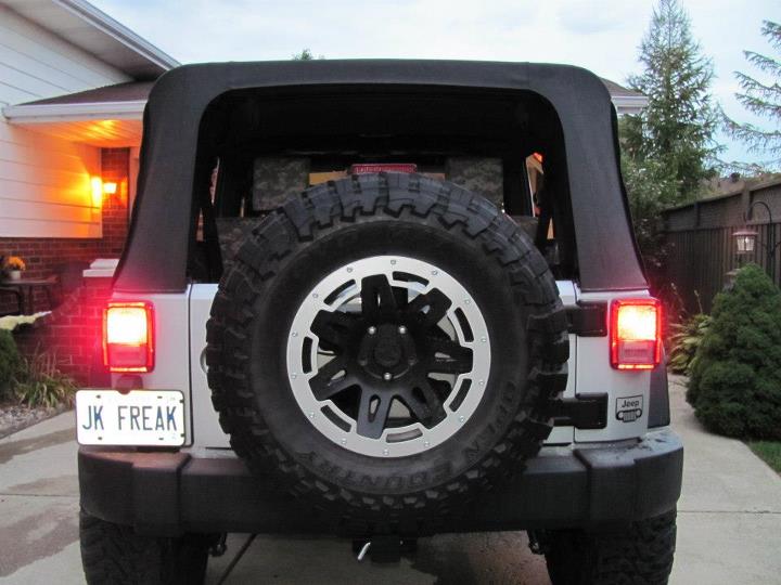

why not have the best of both worlds.....all black rim with custom painted silver rim protectors.......
