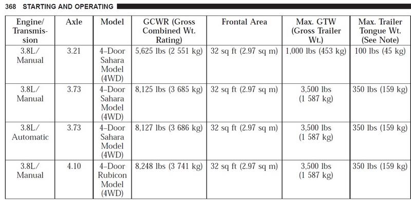

Correct me if Im wrong but when they say 3500# they mean everything gear,passengers, and trailer so that adds up fast. However I agree the jk should be able to handle it without trouble if geared correctly

I think the combined weight including passengers, jeep and towing is 8127lbs, but i could be wrong about what GCWR really means
