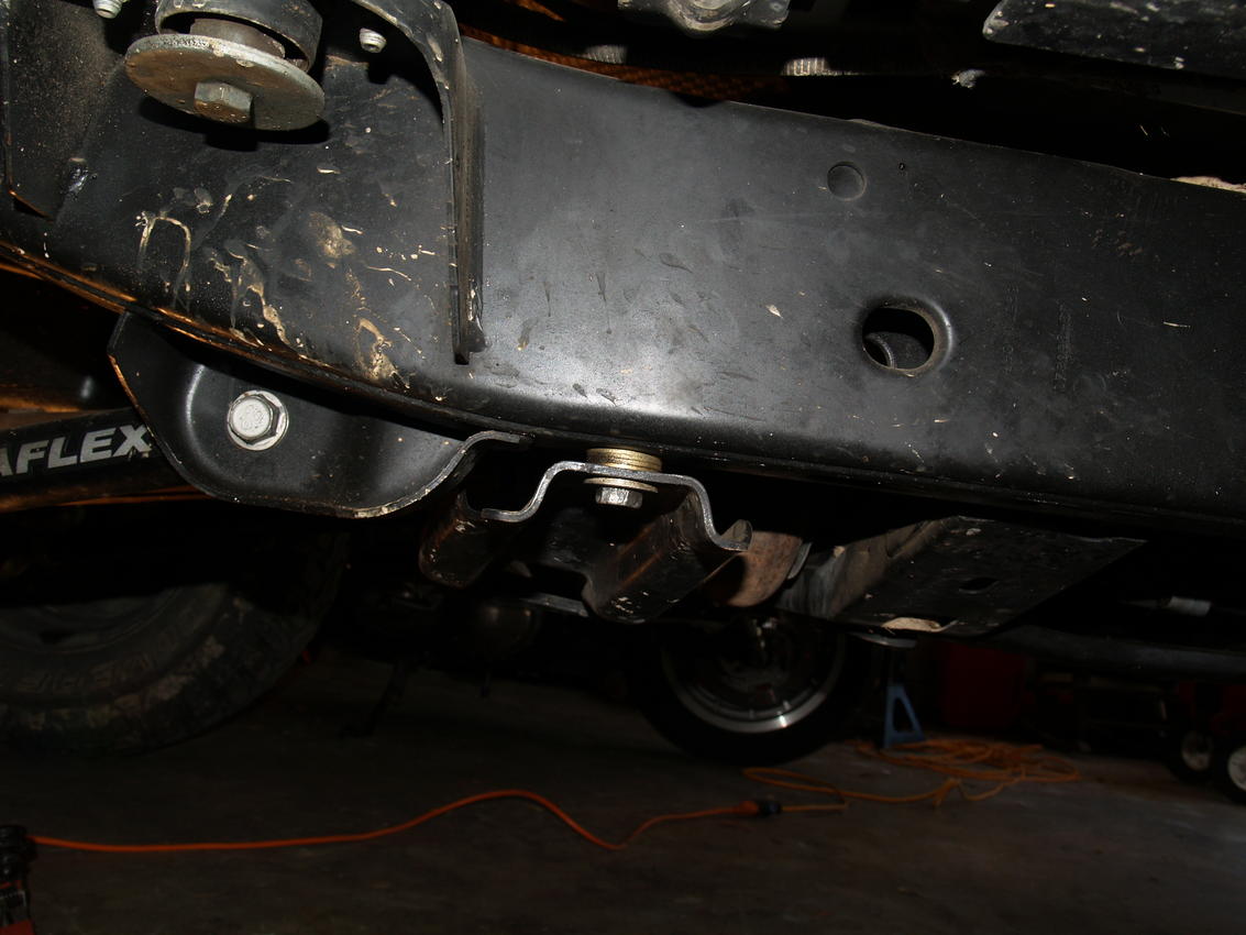

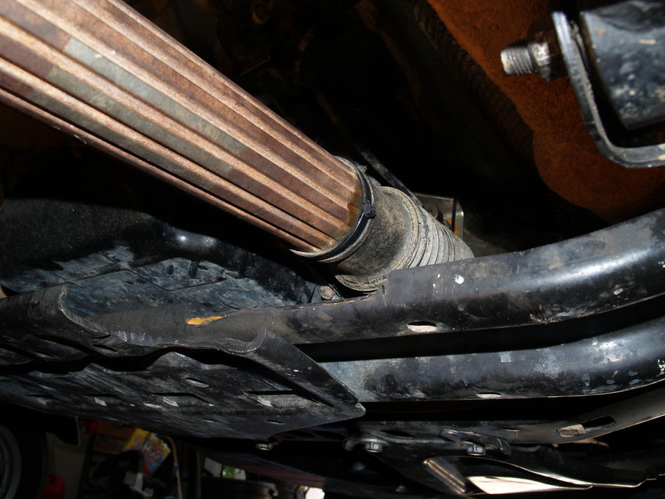

With you running 33's, I wouldn't worry about changing your axle shaftys right now. On a 4dr the frt DS will last you a good while with the manual tranny, if you have an auto , the major thing that happens is that the DS boot will catch and rip on the skid and or the tranny pan. There have been several people on here that have run the frt stocker for a good while even with the boot ripped. You could do something like I did to mine. Take the metal clamp off the boot and replace with a ziptie( that clamp will catch your tranny pan and possibly cause a leak, it has a lump that sticks out on it). I also lowered my skid with washers and trimmed the hell outta the skid/crossmember. I'm not saying you won't rip the boot with this set-up, but it makes it abit less likely.
