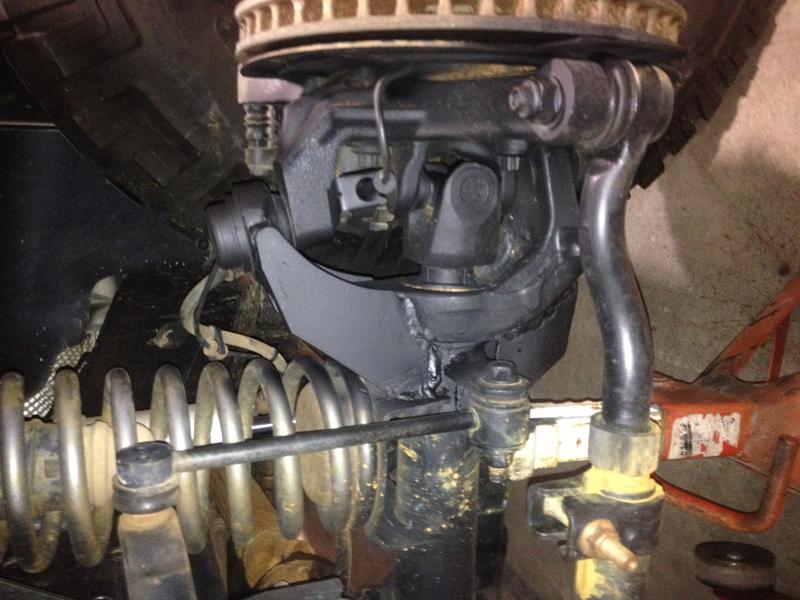

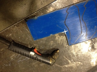

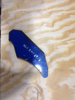

Built these a couple months back when I went up to 37's. Didn't want to bend my D44. Moving up to a 60 eventually but these will do for now. 1/4 inch plate cut and TIG welded to the axle. The welds look funny in the pic I noticed but they are fully welded to the top and bottom of the "C" and to the spring mount. Click image for larger version

Looks good.
