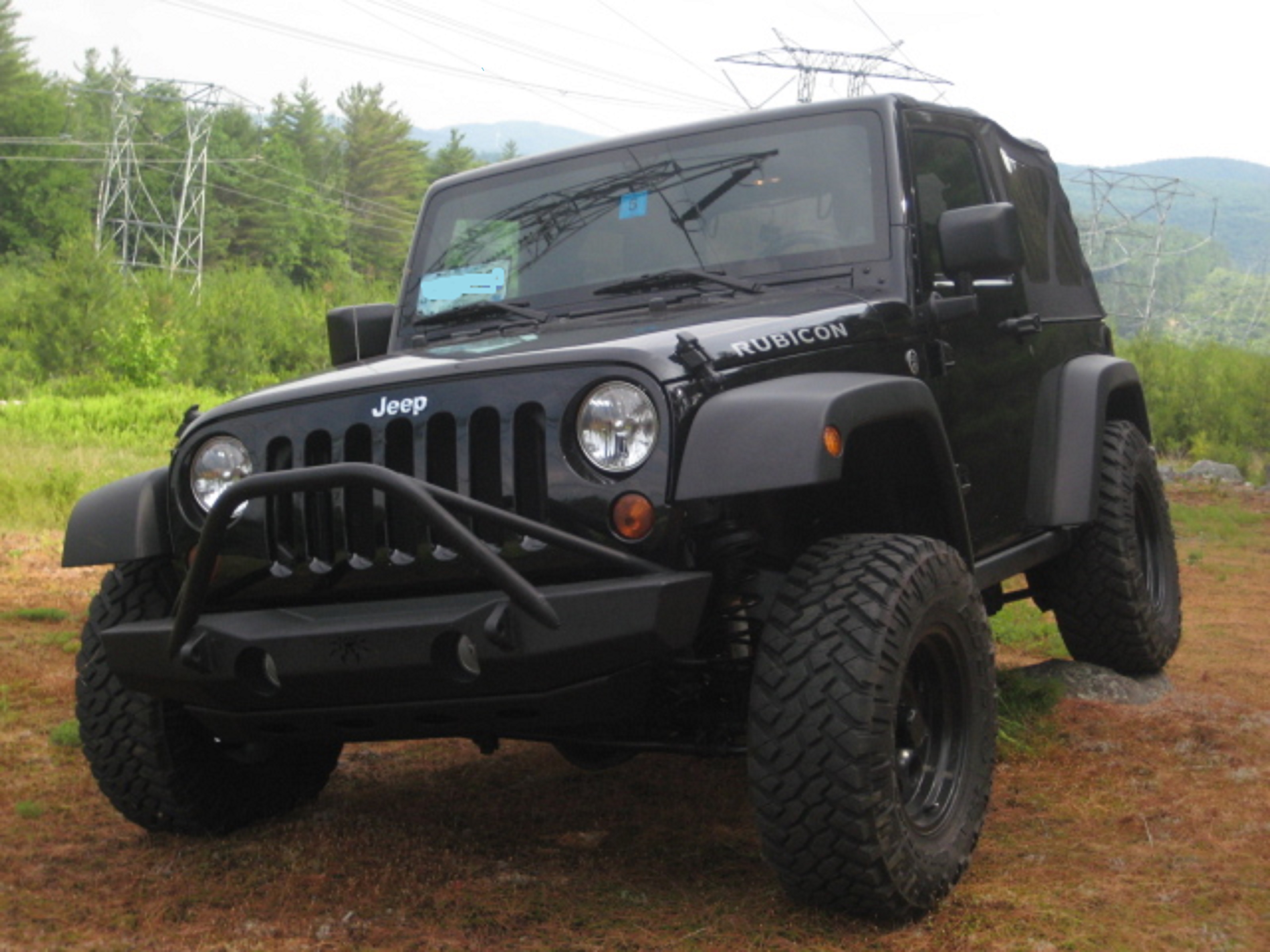

Default i have nitto trail grapplers E rated
they are stiff i guess so people say ( ill believe them) but im pretty happy with them over all , if they are stiff ? well maybe a st of d rated would be my next choice if made in the same size for mine being a 285/70/16 otherwise id get another set of these E again . Dont seem to bother me much at all that i can say would steer me away . At least for my use and they are as tough as nails it seems might not be good when you air down low i dont know ! i keep mine at 30 for my needs . i will add this
in winter at temps around -30 f they feel a bit stiff till you roll on pavement for a mile. but still i dont see a issue . people who are in rocks know more on this though im sure.
