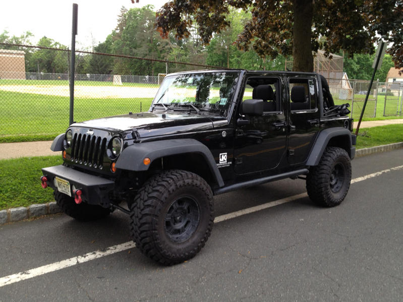

I have a 2012 and had to change my front drive shaft when I put the initial 2.5" lift on. This is 315/75 16 toyo's with a 2.5 teraflex and a 1" spacer all the way around.

It's going to be relative to your Jeep and what you have done to it. Previous to my lift I had swapped out my OE springs for stiffer OE springs. I also swapped out my OE bumpers for Mopar steel bumpers, and I added a winch, so my net gain wasn't as much as others have reported. Unless you completely stripped out your rig, the height gain from a 2.5 inch lift shouldn't create enough height to need a new driveshaft.

If you added leveling pucks or a body lift, then you added more than the 2.5 inch lift so in essence you installed a 3.5 inch lift.
