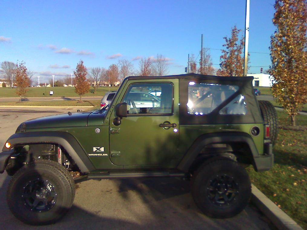

I was wondering if anyone can help me...
I recently had a 4" Rough Country lift kit installed, new 16" teflon coated wheels and 33" Toyo Open Country tires.
Initially, while I was driving it home from the dealer, the front started swaying back and forth and then the ESP light came on flashing, my front end felt like it was sliding on ice and my anti-locks kicked in. Naturally I took my Jeep back to the place that installed the lift kit and over the course of about 3 hours, they finally figured out that the lift kit they installed required a bolt to attached to one of the steering components in order to make it not self-adjust or something like that.
Anyway...now that everything is working properly, I cannot help but feel like every little bump makes my Jeep bounce excessively and overall just seems a bit unstable. I don't know if I take it back if there is anything they can do to help correct this, or maybe the larger 35" tires would help this, but if anyone has had similar problems or feel the same way, please I could use any assistance possible!
Thanks!!!
In case you all would like to see a picture...quality not that great, but you get the idea Click image for larger version

What was installed with the lift? It sounds like you don't have enough caster angle, which will make for a hairy ride and having to constantly steer it. My 3" Teraflex lift did not come with adjustable control arms and caused a similar feeling of having to steer it all of the time. A larger tire will only make this worse, you need more caster angle. Also you may not have an adjustable track bar, and your axle may not be centered from side to side.
As far as your traction control activating, mine did this as well. If your steering wheel is not centered while driving the jeep thinks you are in a skid and activates this to correct the skid. When your ride height changes you steering wheel needs re set to be straight. There is an adjustment sleeve on the steering arm coming off of the pitman arm, this is where you can adjust your steering wheel angle with out screwing up your alignment.
Good luck!

first off, how much air are you running in your tires? with 33's, you should be running about 28-30 psi. any more than that and you are running way too much. let some out and that will help things out. second, the bouncy feeling you are now experiencing could just be the new shocks you are running. RC shocks are basic hydroshocks unlike your factory gas charged shocks and they will feel a bit bouncy. as far as instability goes, your kit should have come with cam bolts. if they were installed, you can adjust them so that you will have more positive caster. that will help out a lot too. and, if you are still having esp issues, make sure that your steering wheel is centered.

factory caster is +4.2°. once lifted and on bigger tires, something closer to +6° will give you a better feel and keep your jeep from feeling flighty at higher speeds. regarding tire pressure, definitely give that a check and lower it to what i recommended.
