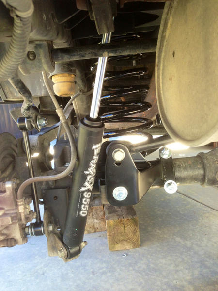

Instaled teraflex 2.5 coil lift today
Old Jan 21, 2013 | 05:22 PM
ryanfreeland's Avatar
Joined: Oct 2012
Posts: 33
From: goose creek, SC
Default Instaled teraflex 2.5 coil lift today
So today I put in the lift. A lot of parts so I was hesitant on doing it myself. Found teraflex's YouTube page and oh boy did it help ALOT! They say it takes around 4 hours. Took me exactly 4 hours! Highly recommended lift. Great job teraflex!

Remember to adjust your steering wheel as to not mess with your BAS EPS system (breaking). SHould look real nice.

Looks good have a shot of it on all 4 wheels? I just did my teraflex springs with other misc parts to fill in the lift last month and love it!

I would be scared driving that close to a pool... the concrete is much thinner than a driveway, and it tends to be hollow or loosely packed dirt. Its a recipe for disaster to have something that heavy that close.
Other than that, good job! Installing your own stuff is very satisfying
Old Jan 22, 2013 | 01:43 AM
Tripletsi's Avatar
Posts: 1,208
From: Pittsburgh, PA
^ What about the jack stands stacked on multiple 2x4's! Yikes!!! Not to mention the unsecured block on top of the jack. This is a safety scenario disaster zone! At least the wheels were chocked!
Anyway, nice job, looks good!

That'll y'all. We put the pool in so we know where the safe spots are and as far as the 2X4s...you gotta so what you gotta do haha

The 2x4's are there to prevent the concrete from chipping! Nice work can't wait to see some off road pics!
