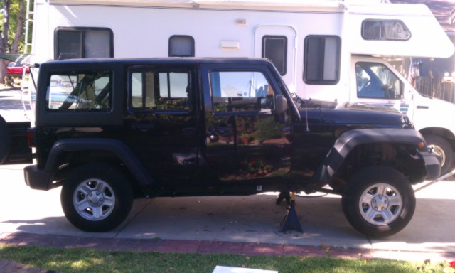

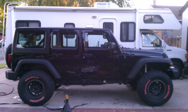

Finished my lift today but the traction control light came on any ideas why. Before and after pics

Old Sep 16, 2011 | 06:53 PM
mabaty's Avatar
Posts: 46
From: Boise
Dam@, big difference, looks good. Have you reset the ecu?
Old Sep 16, 2011 | 06:56 PM
nthinuf's Avatar
Posts: 11,463
Likes: 165
Center the steering wheel
Old Sep 16, 2011 | 07:05 PM
T&ERun's Avatar
Posts: 842
Likes: 9
From: St Louis
Originally Posted by ECHO
Yes sir.. very touchy system if you do a lift and don't straighten the wheel.. the light is on
Yes. Straighten the wheel and it will go away. Jeep looks good.
