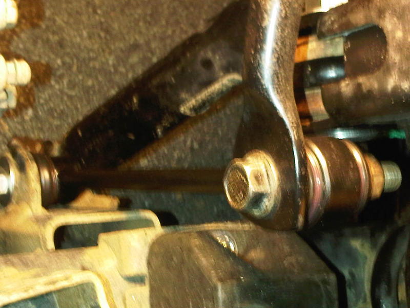

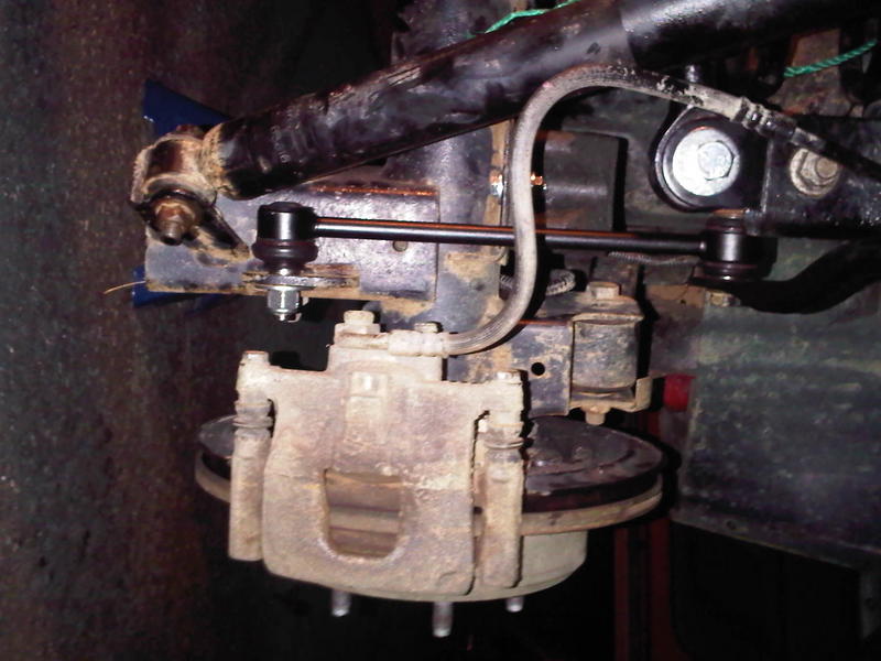

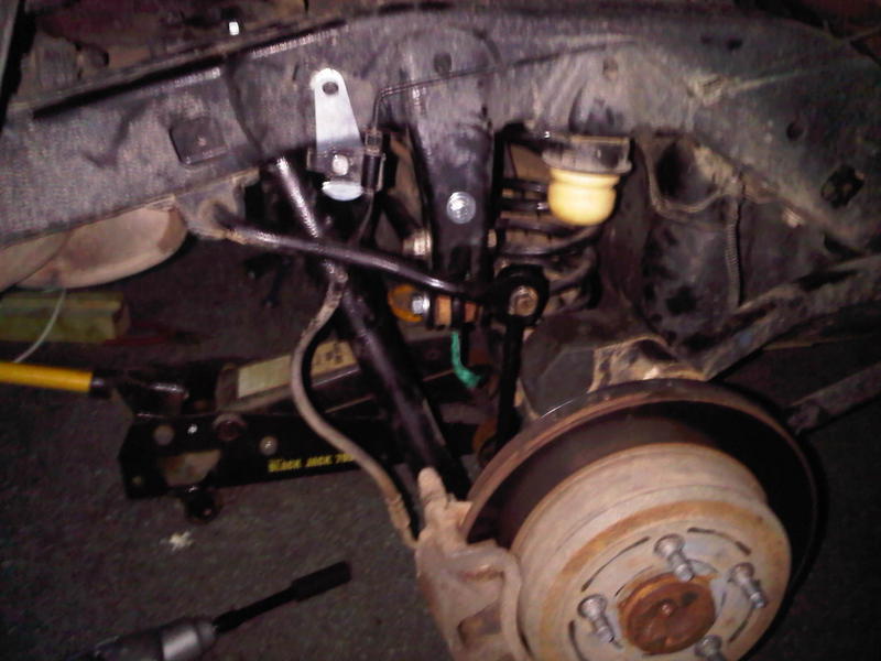

Just installed the rear part of the 2.5" teraflex BB. Instructions are terrible... just horrible. Only real problem was the swaybar links are much different than normal, i wasnt sure if the flexible boot half of the link goes top or bottom, i put it on the bottom. Anyone see anything wrong?

That's wrong, flip it... It's supposed to sit just like the factory link. As for inside or outside I've seen both ways and to be honest see which way clears your wheel, rotor, and the like when flexed...
If you download the directions for the coil lift it has all the details in regards to the sway bar links...

Just installed this lift last weekend. The front sway bars are boot on top outside of the sway bar inside of the axel don't remember about the rear if you don't figure it out let me know and I'll lay under the jku and let you know

Had this lift. Boot at the top and mounted on the outside of the swaybar and the outside lower axle mount.
