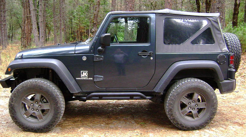

I installed a RC 2.5 susp lift as well. On RC's site, they do mention that the front sits higher for a more level stance compared to raked. My experience with the RC lift, you get what you pay for. Rough country = rough ride. I stiil have the RC coils, but replaced the RC 2.2 shocks with Bilstein 5100's, added a 3/4 inch poly coil spacer to rear, 1/2 steel spacer to front. I did have to put on rear track bar bracket, brake line extensions, sway bar discos, front adj track bar, and front lower control arms. Running 295/70/17's. Enjoy!Click image for larger version

Nice jeep. Can I ask why you need the track bar and front lower control arms? Just trying to see what I need.
I drove my 07 jk with 3" coils for 2 years. No other parts just quick discos. No problems at all.
I have plenty of room for flex with my brakelines on the 2012, my steering is straight, and compared to my buddys teraflex 2.5, there is no noticable differance in ride quality. To be honest, I cant even tell the difference in ride quality from stock.

Thanks. I added front adj track bar to re-center the axle, 3" put it out to right just a bit so the jeep was crabbing. Lower control arms are neccesary for lifts 3" and above to correct the caster angle=driveline angle, also helps reduce the 'flighty' touchy steering you get with 3"+ lifts. Also, you get better clearance with a aftermarket longer control arm. For a little extra ease, I added RC's dual steering stabilizer set up, works great.
