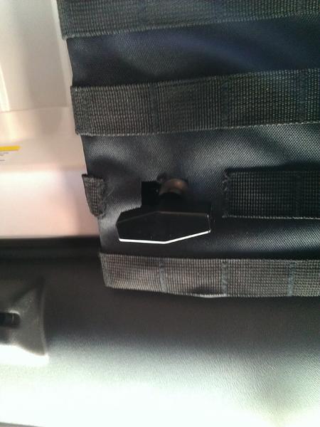

First post here ... I just installed a Smittybilt GEAR console in my 2010 Unlimited. I had to remove the drivers side front latch as it would not even come close to sitting down flush. So I removed the latch, then drilled a hole in the steal console support right below the hole in the hardtop. I bought some threaded rod and a small plastic "T" handle at Lowes. I then cut a small hole in the webbing portion and I now have a quick way to hold the top down like it needs to be. Hope this makes sense.

Not to bad, I just added some 3/4 inch brackets to the mount and that lowered it enough for me to fit my hand below the latch in order to lock the top into place.

I am going to have to do what you did with the t-handle. I had to remove to get it to fit on my 2014 and it pops up now just enough to make me wonder...
