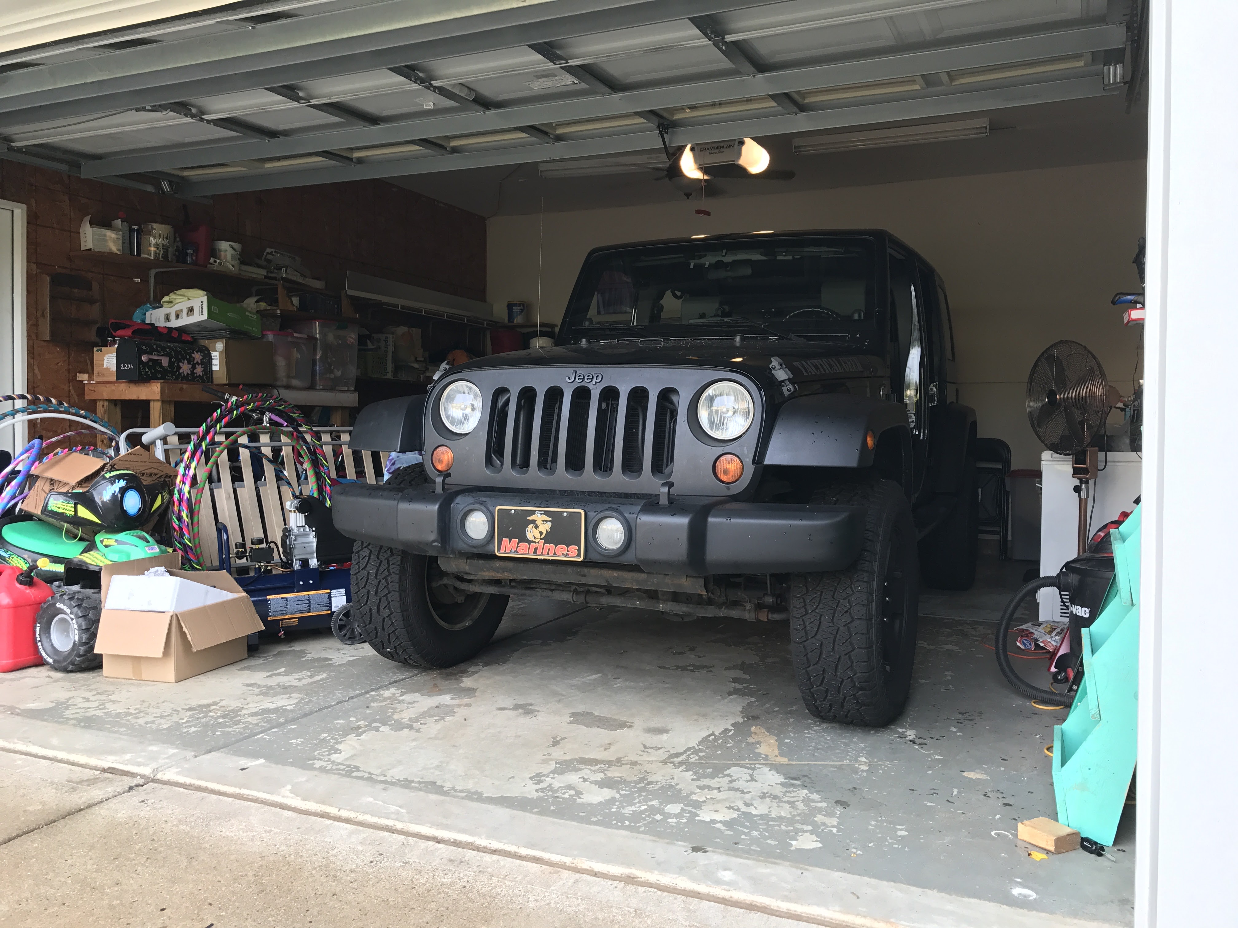

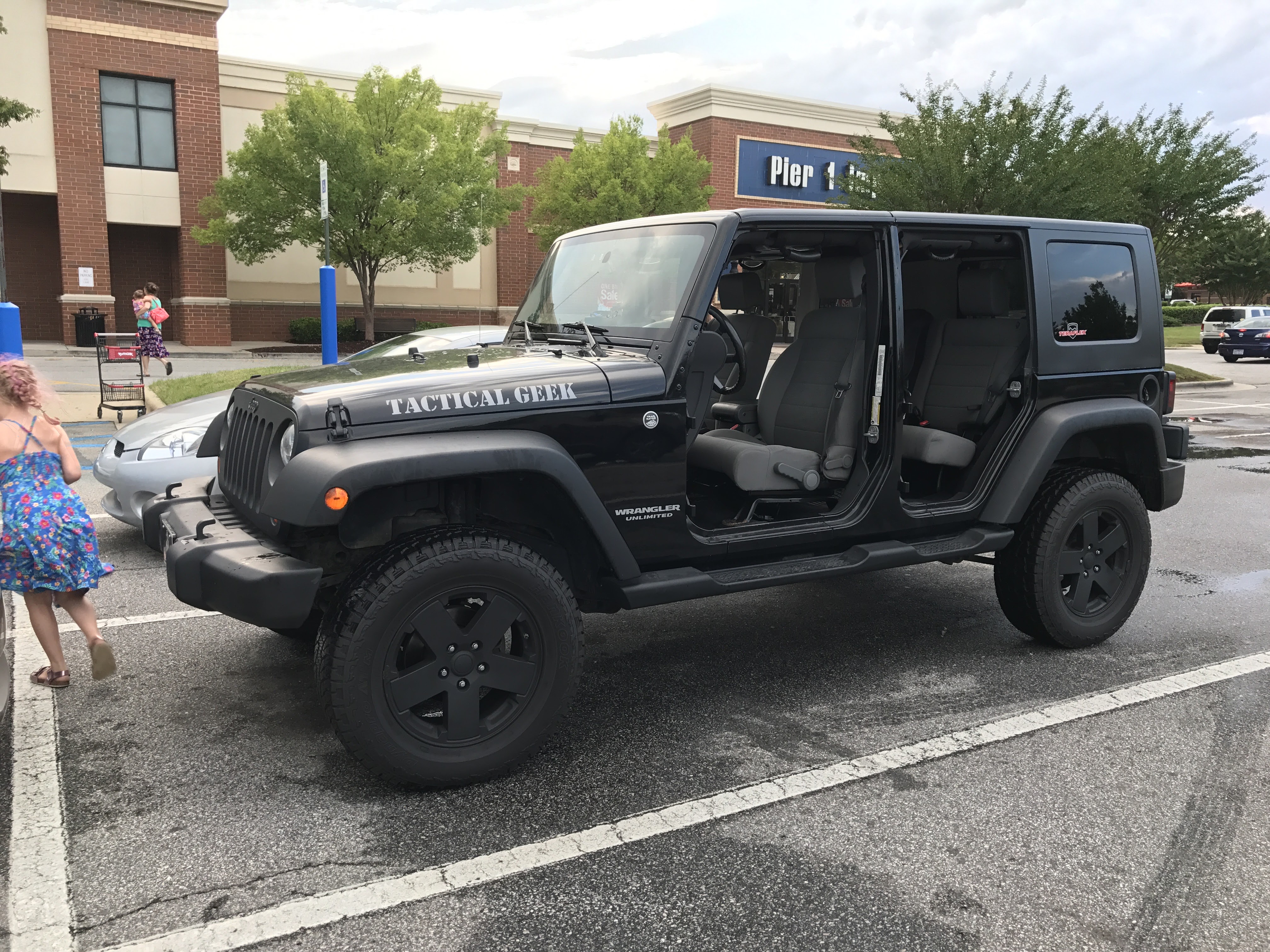

Thanks for the tips everyone! Ended up getting a new jack and jack stands as it made the job a lot easier. Took a day and a half because everything was good and rusted but I got her back together with the 2.5" lift installed.
