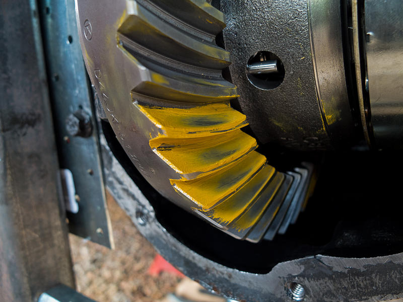

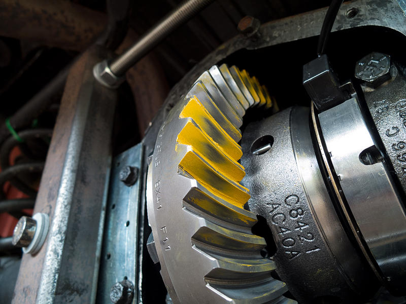

This is the first time I'm installing new gears. My Jeep is a Wrangler Unlimited Rubicon 2008. I would like your opinion on my gear patterns before moving on with the installation.
First try:

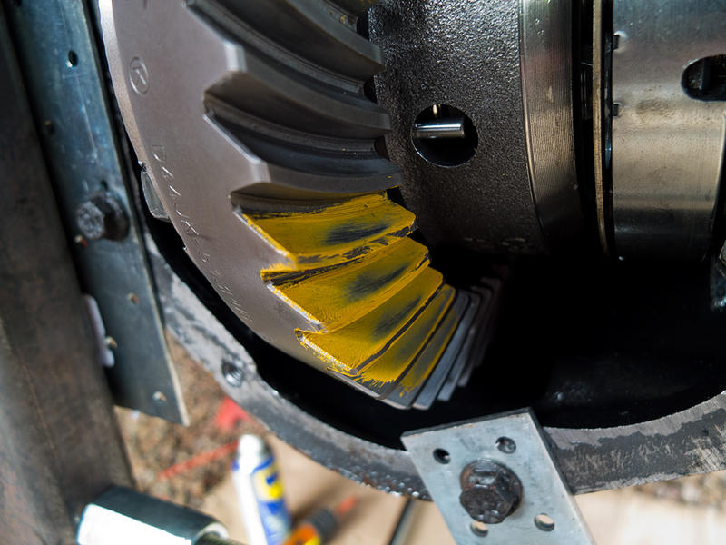

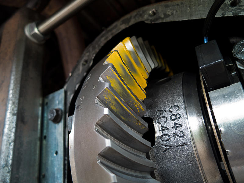

Then I added a 0.1mm pinion shim:
What do You think? Is this enough or should I add another 0.1mm?

I am certainly no expert but from what I can see it looks good. Looks centered on both sides. How did the rest of the install go? So what kind of pie is it?

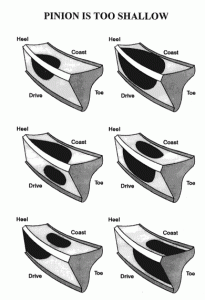

I've never done it, but looks shallow according to the chart. Subscribed.

Hmm perhaps I should try to add 0.1mm?
Old Jun 30, 2012 | 11:41 AM
DanieltheManual's Avatar
Posts: 456
From: BC Canada
Yep. .1mm till close then use .02 to make perfect.....this only what ive read........

Did you do the imprints under load? It will make a difference.
