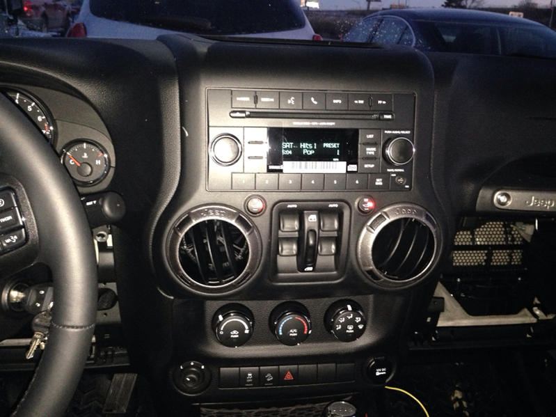

I just finished today ...feels like minus 10 in NJ
...I installed Amazon $59.99 kit ...( I installed previously on another car )...
I also install the mopar kit on my 2010 ...nice plug & play but about $200 more than the Amazon ones ....
My JK is nice and Toasty ....didn't have much of option on the rocker switch placement
