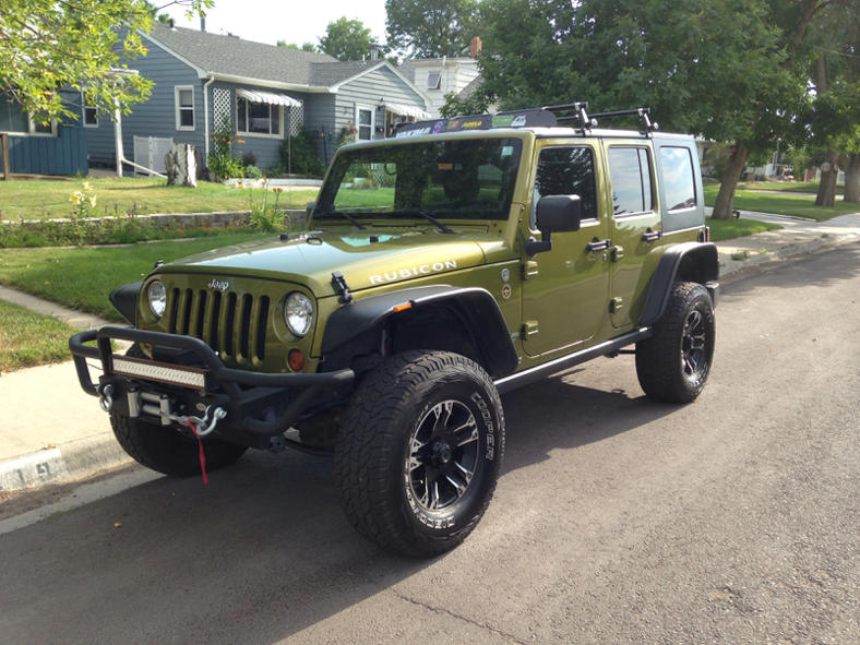

I recently installed a rough country 2.5" spacer lift on mine. Very happy with the results. The front spacers were about 3" tall to level the jeep out. And again, didn't have to disconnect the drive shaft. I did have to use a spring compressor on the passenger front coil though. Here's how it turned out.
