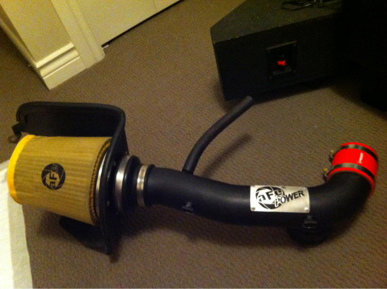

AFE on my 2012 with the pro guard 7 oiled filter, this thing is great as long as you don't plan to play in the water. Go oiled! Also i highly recommend the prefilter.
