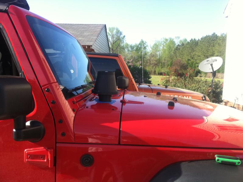

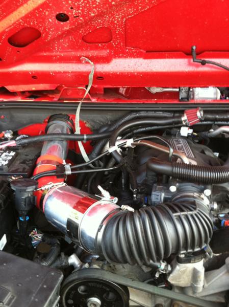

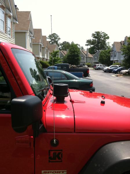

Buy the parts from siliconeintakes.com and build your own... Or, do a custom snorkel/CAI..... Parts were (filter, elbows and clamps) were $115.... I now run it with a spectre performance in-line airfilter. I was averaging 15-15.5 mpg without it and running 32.5" mud countries and now I'm averaging the same with 35" KM2's... Much cheaper to do it yourself...

Nice looking setup

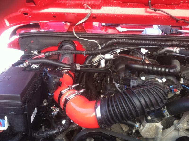

Thanx...... I was also running it with a K&N type filter before the pre-cleaner...
