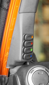

do you hit your switches with the shifter? i had one but sold it to a friend because of that issue now im geeting the one for the driver side a piller.

this is the one i am going to get Click image for larger version
Name:	A Pillar switch pod.JPG

Originally Posted by fleetwood8890
this is the one i am going to get Attachment 281085
where did you get that panel? ive never seen it in any catalogs??? I like that!!
