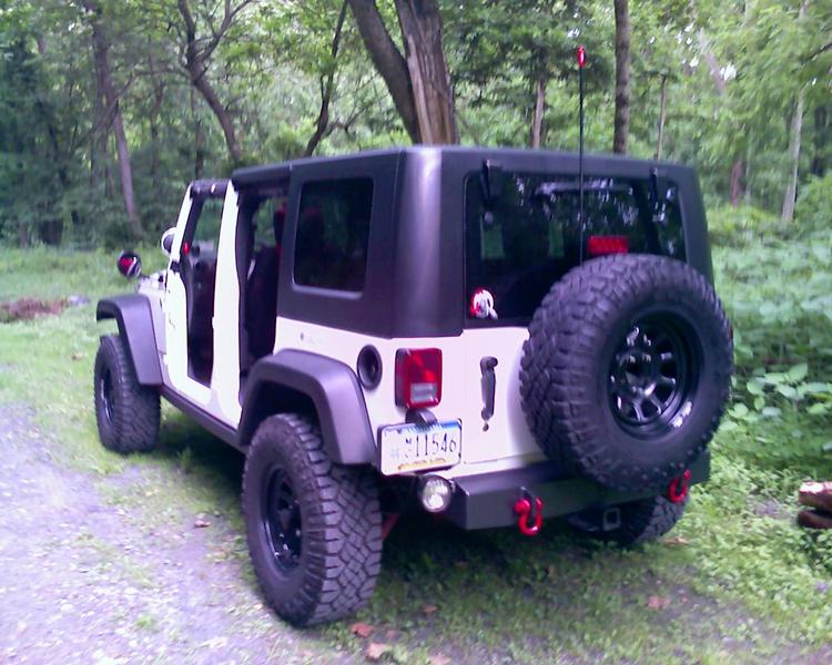

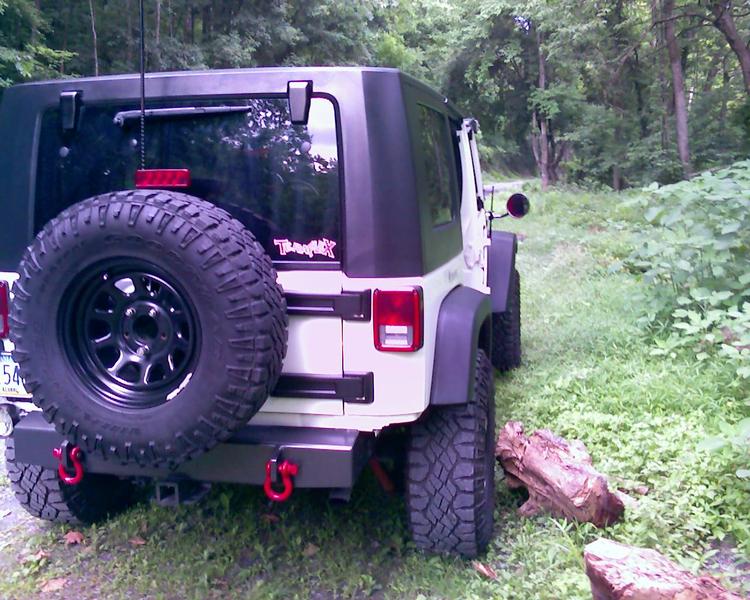

Rubicon John's Avatar
Joined: Oct 2008
Posts: 545
From: Lehigh Valley, PA
Originally Posted by redwagon
Thks guys. I'll checkout the JCR
I went with the JCR stubby and kept my factory tow hitch. JCR makes a great bumper and you can paint it the way you want.
