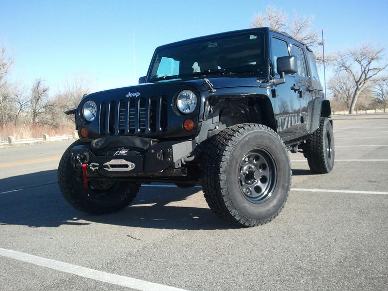

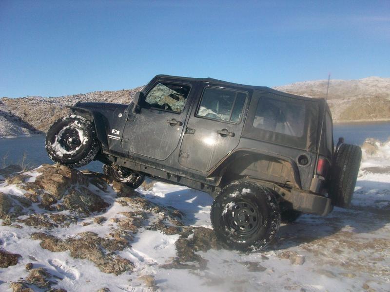

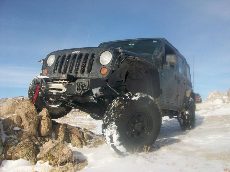

Not gonna throw slings at this guy but I do not think he gave you great advice. I currently am running a RC 2.5" lift with 285/75's (32.8x11.2 but these actually measure about 32" ) and chopped stock fenders, with my setup at full flex I definitely still have room for 35's, even when I was running the stock fenders (non chopped) at full flex I still had room (was a little tight in the rear). I am looking at upgrading to 35's very soon. As far as with the stock (non-chopped) fender, there are plenty of people on and off this forum that will tell you that they run them with 35's no problem. There maybe some rubbing depending on your wheel size (backspacing) but do some more research (that's part of the fun of owning a Jeep). Remember, just because someone is nice doesn't mean they know what they are talking about and/or are giving you the best advice (not that mine is awesome advice either, I can only speak to my experience). Also check out the "sticky" thread in the modified JK tech under suspension for some answers to some of the basic lift questions and might help you in your research/learning journey. Best of luck and don't forget to post pics of what you end up doing!
Here are some pics to help illustrate:
ID:	249840 Before, middle, and after lift (non chopped fenders)
Name:	2011-12-11 11.45.26.jpg
ID:	249841Click image for larger version
Name:	2011-12-11 11.46.43.jpg
ID:	249842 Fenders chopped
ID:	249838Click image for larger version
ID:	249839 Flexin w/ chopped fenders

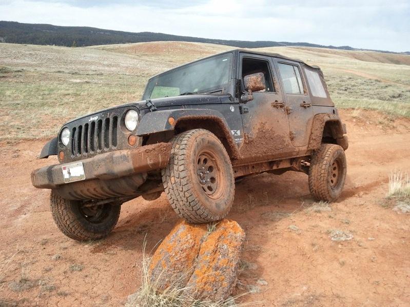

Some more of stock (non chopped) fenders and flexin':
