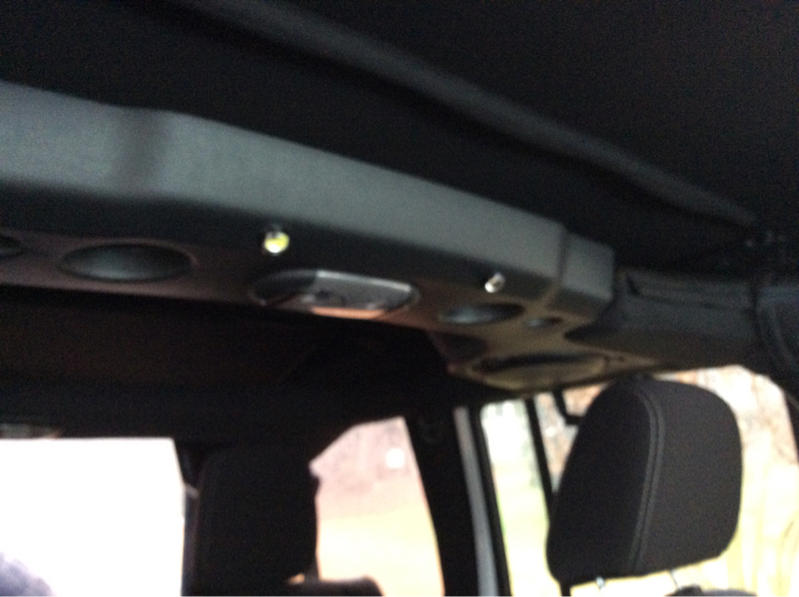

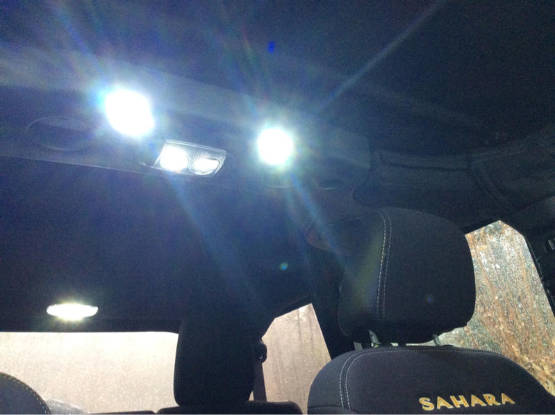

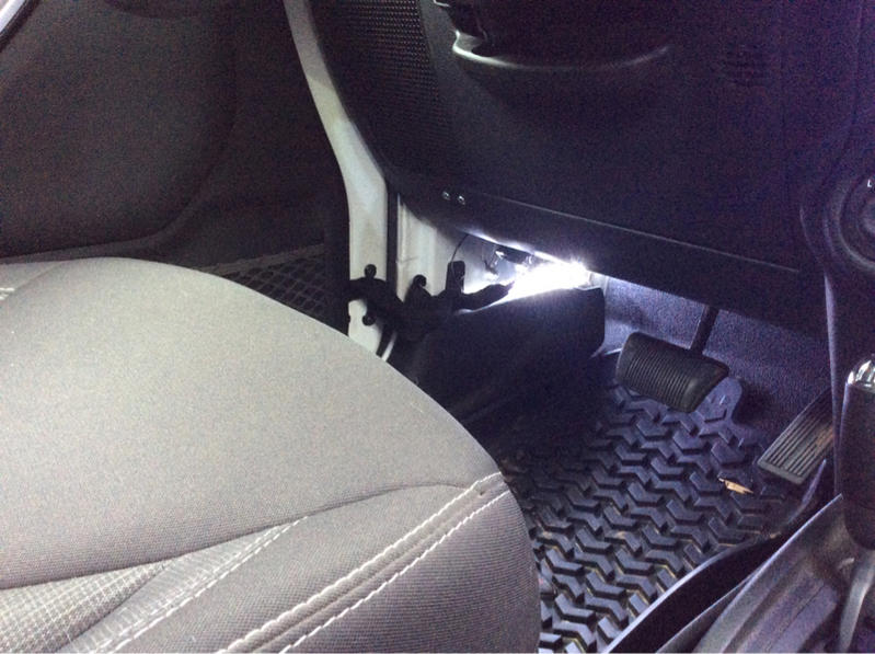

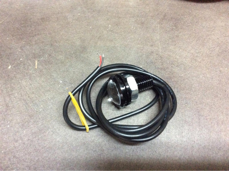

There are several threads on here showing that. I bought several LED strips at Autozone along with a few LED bolts. I will take pics in a minute to show you. If you have a newer Jeep it's easy to add them. I have a 13 JK which has a small LED light already in each footwell and I just pulled it out, cut the wires and attached the LED strip to it. I then went up to the sound bar and pulled it off and soldered a LED bolt to each side and put them facing forward and down for each front seat. I also swapped out both front and back factory lights with aftermarket LEDs. They are brighter and white unlike the factory yellowish ones. I didn't want them to look different then the color of the LED strips. As far as I know you can't change the map lights which isn't a big deal because they are useless anyway. I flipped my mirror upside down anyway because it gives a better view and put a piece of black electrical tape over each one so you can't see them when they come on since they don't match the white LED color either. The only time you would see them is when you unlock or lock the doors with your keyless entry. The sky is the limit on interior LED's. Bolt lights on eBay are pretty cheap.

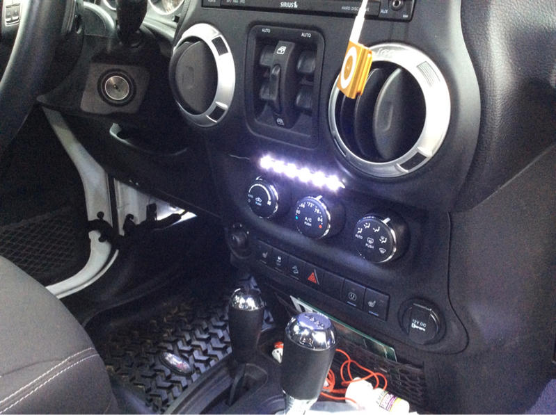

Do a eBay search on LED bolts and you will find them pretty cheap. With that said, luckily I ordered several extra since they were so cheap and come from China and one out of the six or so I ordered broke pretty easy so I had a spare one. LED strips come in two packs at Walmart or Autozone and are pretty bright. I put two in the passenger footwell, one in the driver side and one on the center console that you can see in my pictures. I have tons of bright light.

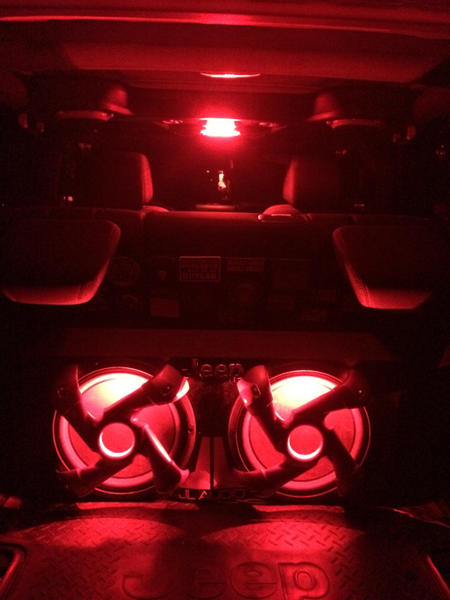

I added red led's The dome lights and footwells. Then I also added some to the cargo area into my sub box.
