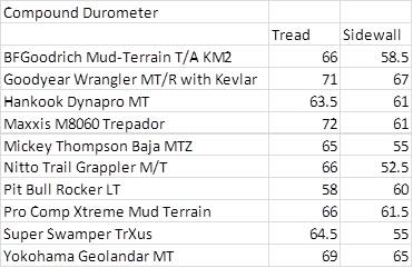

I've been really disappointed with my 37" MTRs in the rocks. The tight center tread pattern and hard compound just doesn't get traction.

its more the fact you are running a D rated tire and too stiff a sidewall and extra belts that don't allow the tire to mold around the rocks and grip. The MTR/K does not have a hard rubber compound and the C rated tires have great grip in the rocks.
