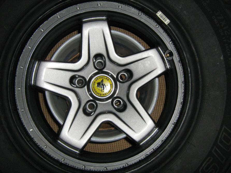

here is what I am dealing with. I can't get the wheel to sit inside the bead. If one side is right, the other is off quite a bit. And I am still wondering if the 1" thickness of the bead is too much for the rings to clamp down on. Hopefully I can talk to AEV Monday morning about that.

thats looks normal to me .. you just need to use something to get that bead around the wheel.... you could try to use alittle tire lube and something to pry the tire around the wheel, working your way around and it should pop on their.. did you try a rubber mallet ? it should eventually fit around the wheel.. just takes some work. mine beadlocks where the same way , but i got them on their... hope they work out for you .. nice looking wheel. oh i also bought mine inside to work on ... much warmer

I also had a set of AEV bead locks with 35” KM2’s and my lock ring did clamp down tight to the rim at 15ft. lbs. of torque. I recently went to Walker Evans bead lock rims. I used soapy water in a spray bottle and a couple of pry bars to work the bead around the that lip. It looks from your pictures that you may have a little further stretch than I had but, I think with some patience and two pry bars you’ll get it!
