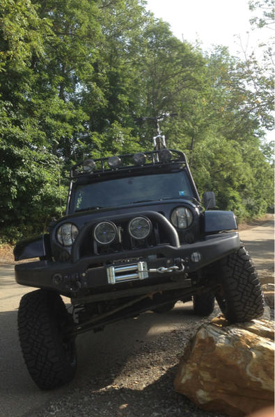

I'm thinking they're right. My AEV opening is probably similar to your ARB and I had to mount the solenoid on my winch to the grille. It wouldn't fit over the line and definitely would not have fit on the side.
