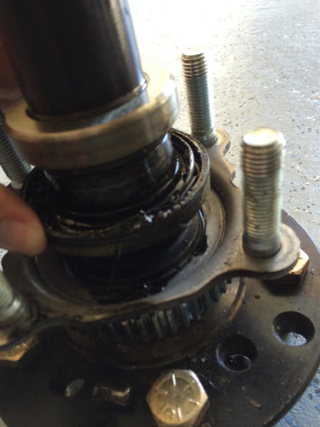

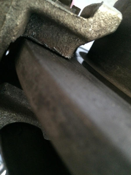

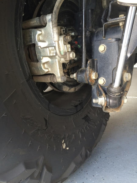

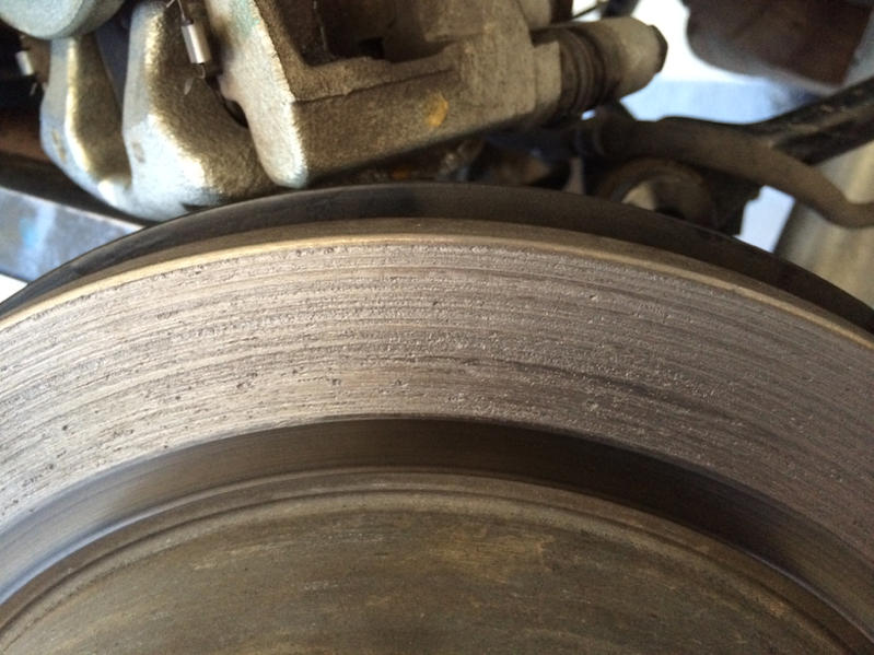

A little update, got tied up with work and had to leave town, so just pulled it apart this morning, when I pulled the tire off there was clear metal on metal rubbing from the brake caliper and the rotor. Pics attached...

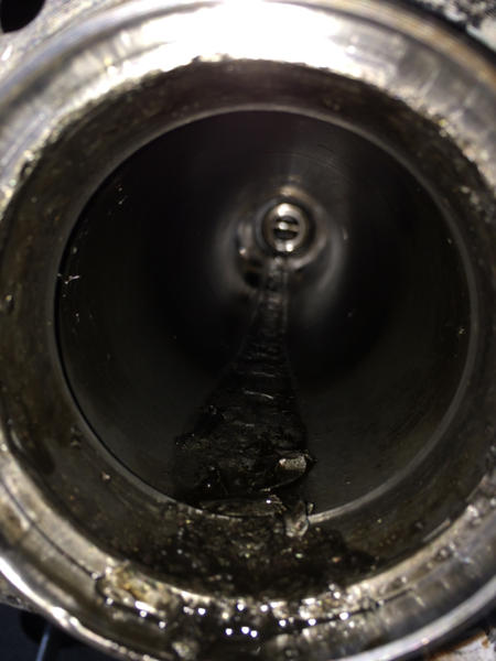

Then when I pulled the shaft the thing just fell apart on me, bearings and shards of metal everywhere, grease in the axle tube etc. Pics for this as well.
It looks like maybe the axle wasn't either seated all the way in and caused the break caliper to shift and rub the caliper, then with driving, some serious failure to the axle bearings and all of that stuff. Or, could it have been manufacturer error and Nitro didn't have everything pressed on correctly?
I had it hauled into my shop by flat bed to hopefully save any further damage. They are going to see what it looks like and see if we can go to nitro for any warranty issues, or might even have to just buy a whole new shaft.

Thanks, I hope it does too. I have no idea what went wrong. The more I think about it, the more perplexed I get. I torqued everything down. Everything was seated. No noise until I re connected the parking break. Then.....squeaking, squalling, rubbing, grinding.... Then I find this. I don't get it.... I would knew I had a break issue, but never expected the shaft to be like the way it was...
