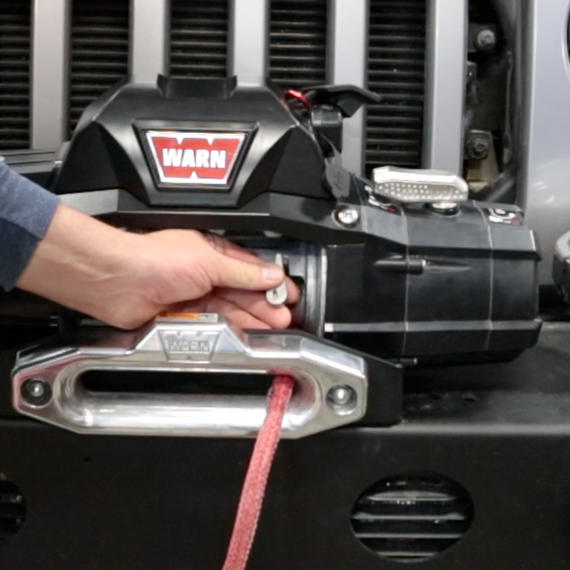

Another reason why I go warn. Its hard to tell in these photos but they went away from the Tiny screw and crimp on the Zeon models and now use a "plug" for better words and there is no way it can hurt the line like that.
The load rating on the new Warn drum is as much as the winch .

Another reason why I go warn. Its hard to tell in these photos but they went away from the Tiny screw and crimp on the Zeon models and now use a "plug" for better words and there is no way it can hurt the line like that. The load rating on the new Warn drum is as much as the winch . <img src="https://www.jk-forum.com/forums/attachment.php?attachmentid=552597"/><img src="https://www.jk-forum.com/forums/attachment.php?attachmentid=552598"/>
It is a nice setup, but a pain to install! After tearing several zip ties, including the one they sent in the box, I finally greased up the line and used coat hangers with some pipe insulation to make a handle. Even then it took all of my strength and weight to get it through. But, that sucker ain't coming out that's for sure!
X2.
Coat hanger, check.
Didn't use any lube, I didn't know if it would eventually break down the rope.
I'm 220lbs, it took all of my weight and strength. Never sat fully flush but seems good to me. Man oh man I hope it's good.
