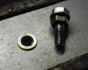

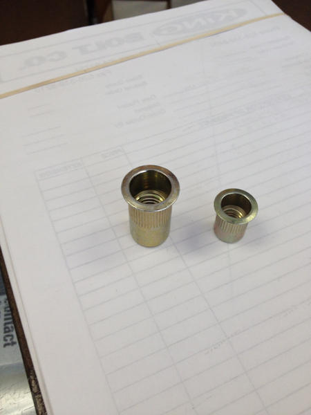

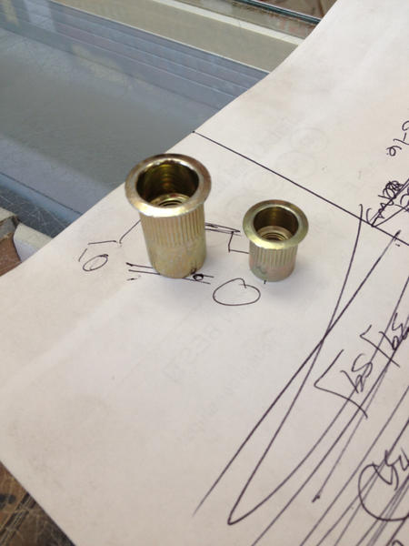

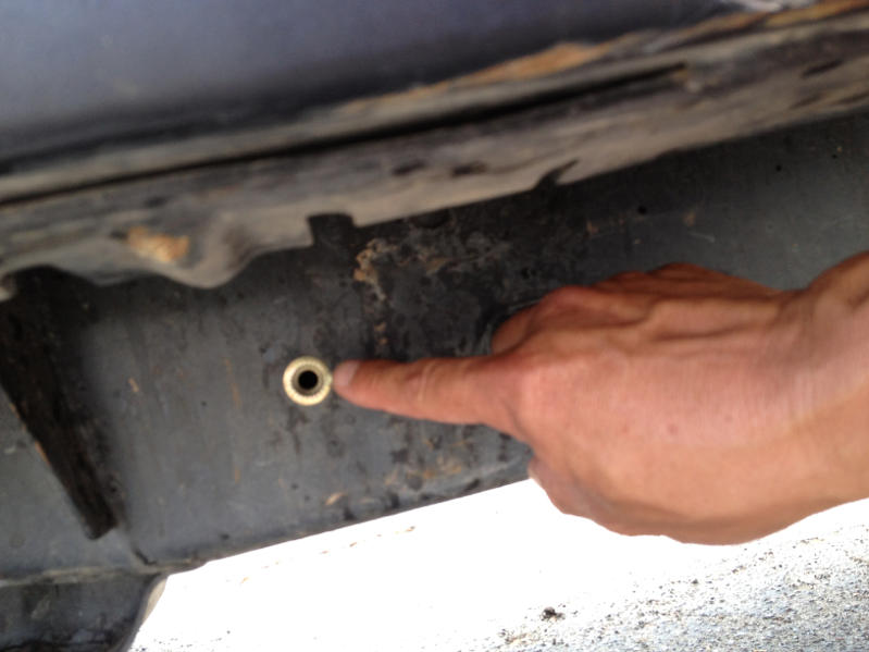

Jack nut has everyone have used them on the JK for their rock sliders?
If so can you tell me your Experience with them.
Thanks
Thanks
<img src="https://www.jk-forum.com/forums/attachment.php?attachmentid=424606"/>
<img src="https://www.jk-forum.com/forums/attachment.php?attachmentid=424607"/>
I've used them for my PSC body armor, not my sliders. Another name commonly used for them is nutsert. They are a huge PITA. It's easier if you use a special tool like from harbor freight to install them. I've never seen them used in the frame, just the body panels.
Old Feb 20, 2013 | 08:18 AM
jdk's Avatar
jdk
Posts: 878
From: Rockwall Texas
My sliders used them but also bolted to the frame suports as well, no issues.
Old Feb 20, 2013 | 10:04 AM
Freewill's Avatar
Posts: 1,715
Likes: 11
From: Olympia, WA
I used them with PSC rails. The nuts are OK, but the "tool" provided by PSC is a joke. If the rails had shipped with a more useful tool I'd have gladly paid an extra $20 or whatever instead of chasing around town putting together a tool that could actually be used.

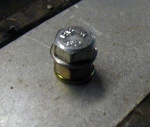

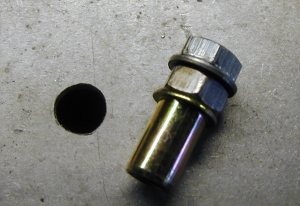

The proper install tool costs around $250.00 and will make your life easy if you have a bunch of them to install.
That being said if you only have a few to do you can manage with a bolt, washer and nut (drill out the threads).
