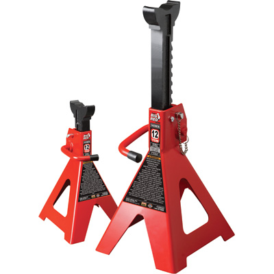

Its not so much the weight capacity, but the lift height. I had to get 12 ton stands, but they lift 28" tall and I can drop my axles no problem with the jackstands on the frame.
Remember, if you do the front first, and rear second (one end @ a time) there will less than 1.5 tons on the stands at any time....so yours will do the actual supporting job just fine.
Yep, same here. Went with huge 12 tons because they are tall so a lot less hassle adjusting shorter jack stands. And they are beefy as hell.

awesome. Plus they make me feel better when Im laying under it
