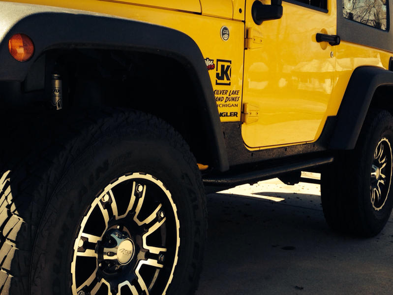

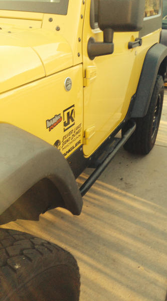

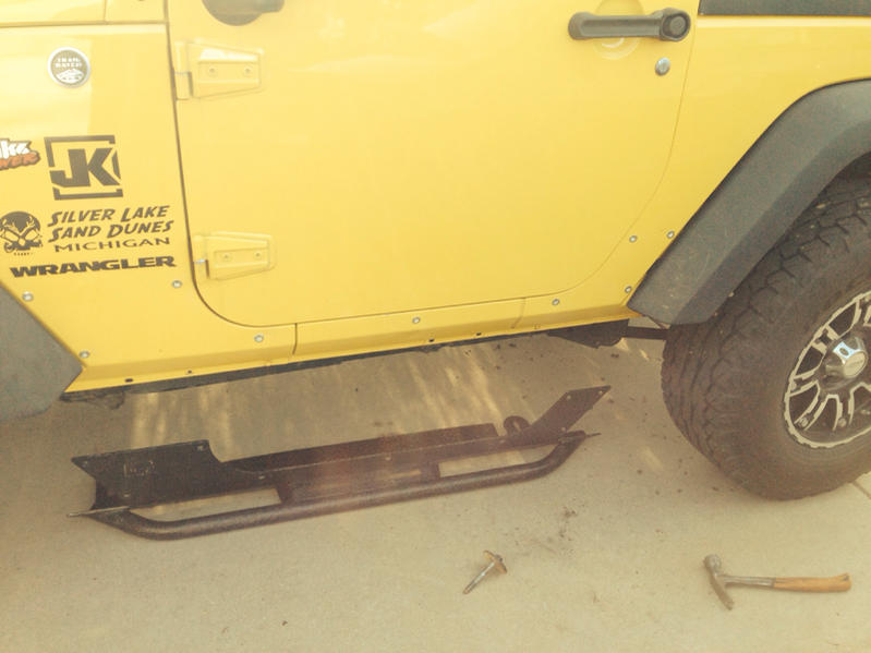

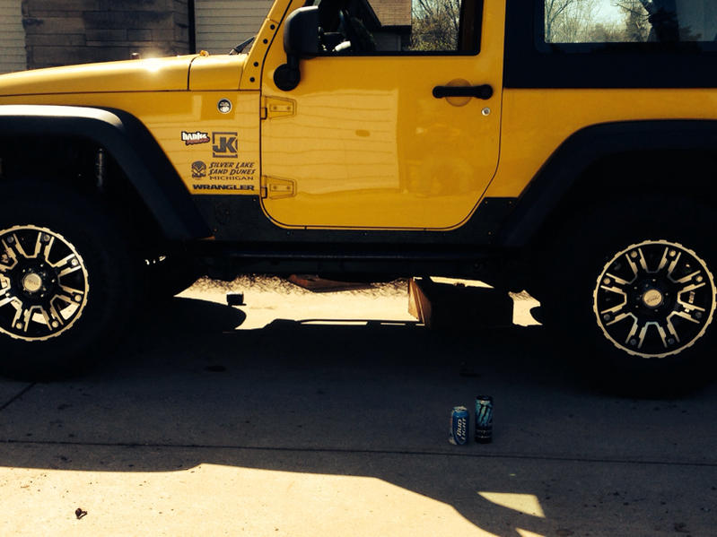

So far install is going smooth but time to drill into the body hope this goes well

Step drill bit is the way to go. Using a regular bit is bad news.

"Step drill bit is the way to go. Using a regular bit is bad news"
I used a pair of "cowboys", vice grips with the wide mouth, to keep it safe for a regular high-speed drill bit.
If I didn't have them though, I would have gone the step-bit route.

I wish I thought of the step drill it turned out good but was a pain to get lined up just right. Has any one used a sealant to help prevent rusting behind their sliders?
Old Apr 28, 2014 | 07:44 AM
Rob 12B1P's Avatar
Posts: 1,470
From: Bakersfield Kalifornia
As thin as the bodies are on these things you could probably get away with a hammer and a sharp nail
Old Apr 28, 2014 | 07:47 AM
suprablaski's Avatar
Joined: Mar 2014
Posts: 137
Paint your drilled holes and you will be fine, just don't want the exposed metal
Old Apr 28, 2014 | 08:38 AM
Invest2m4's Avatar
Joined: Jun 2013
Posts: 3,697
From: Grosse Pointe, MI
I've asked a couple manufacturers and they both say not to seal. It essentially traps moisture where you want it to breathe.
Old Apr 28, 2014 | 10:44 AM
detonatoryel4x4's Avatar
Posts: 38
From: portage, MI
Thanks for the heads up. I'll just be sure to touch up the holes with paint as best as I can.
