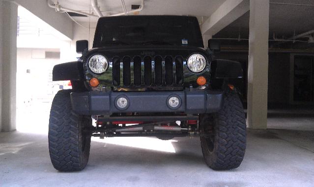

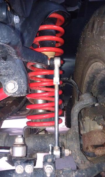

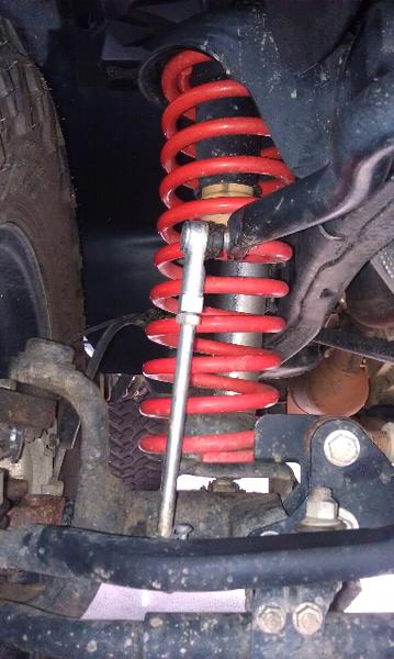

I took a couple pics today. I looks like the passenger side coil has a slight bend in it.

Old Jul 21, 2012 | 07:44 PM
Serg5000's Avatar
Posts: 1,309
From: Palmdale,Ca
This is normal.

Old Jul 21, 2012 | 08:27 PM
BoneShkr's Avatar
Posts: 483
From: West Haverstraw, New York
I'm adding my 2 cts here....
A picture is worth it's weight....The Drivers side is properly aligned,
while the Passengers side has a slight bend.
Check to see that everything is in proper alignment.
I would go so far as to tell you to get that alignment done
professionally, this isn't something you want to neglect... over time
this "Lean" will cause stress on the frame and other suspension parts
that could be the cause of a catastrophic failure.
Just my 2cts.
