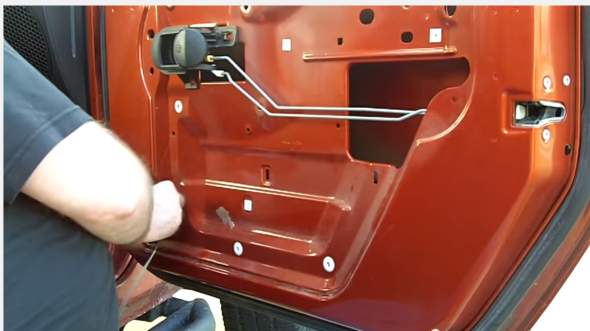

Originally Posted by almost
I can tell you that one source of rattle comes from the door latches when you hit bumps pretty hard. A trick I learned from here is to wrap the metal that the latch latches on to with electrical tape. It takes the slack out and since it is like rubber there is no more sound. You might have to slam the door open and shut a couple of times for the latch to dig in but after that it's golden. One of the best things i learned on this site.
Next thing to tackle is the damn skid plate/exhaust rattle thats coming back again and the A pillar creek that I had for ever.
Are you referring to the 2 metal pole thingys seen here inside the panel? That looks like it could be the culprit of about 25% of the problem.
