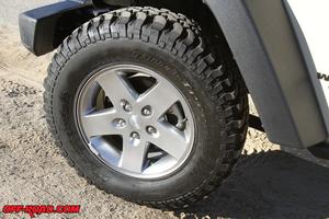

Originally Posted by Croce
What size tires and PSI are you running?
Its just the stock Rubicon set up: 32-inch BFGoodrich Mud-Terrain tires
The PSI is prob very high and its what ever the Jeep stealership puts in, but I doubt that I would ever lower it as I drive long range for work.

Originally Posted by ShiftKnowledge
<img src="https://www.jk-forum.com/forums/attachment.php?attachmentid=531926"/>
Well i would at least see what it is set at. Over inflated tires will give you an uncomfortable ride. I would think stock bfg's should be in the 35 psi range for wear and comfort. Not positive on that . It's the first thing I would check.

Tires are 225 /75/17
35 PSI
