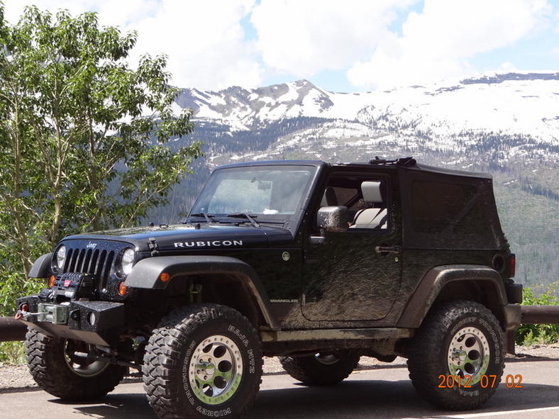

Originally Posted by Marco125
If I have a 2.5 inch aev lift and I'm getting a bumper and winch put on my front bumper will the front of my jeep sag because of the weight
I have a AEV 3.5" lift and a Warn 12,000lb Dualforce Powerplant winch {HEAVY} and a Nemesis Odessy mid width bumper {light} and my lift didnt seem to sag at all it actually sits a little high in the front end. If there 2.5" lift has the same quality springs I dont think you will have any trouble.Click image for larger version
