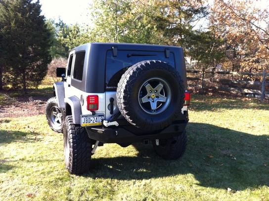

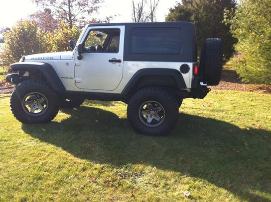

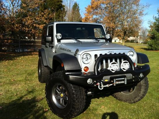

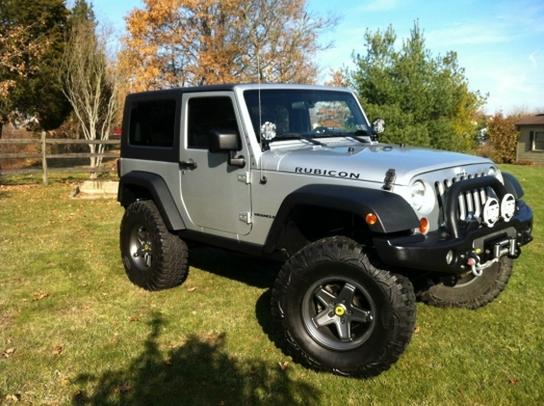

Thinking about buying this... any advice?

Nice freakin jeep.
One concern is the auto tranny and 37's. drive it and see what you think. That's a lot of rubber for the 4 speed slush box and 4.10's.
Assuming if both driveshafts were replaced some thing was done for pinion angles. I am not familiar with that lift company.

Are those pics from a ad? He's got no pics of underneath/front axle and steering ?

I would ask what components were installed with the lift, i.e. adjustable controls arms and adjustable trackbars. Def try and get some pics of the under side.

If you can't see it in person right now I'd ask for high resolution pics of the under carriage. Mainly looking for dent's and scraps. It's a Jeep and he built to wheel it but this could help with how hard he wheeled it.
Also I'd really look at how much your spending on this because it could be worth looking into a 2012 or 2013 with the new engine and then building your Jeep the way you want. Yeah it will take more time but at least you'll be confident because you know whats been done to it.
Either way good luck with Jeep!

Yes these pics are from an add. I haven't seen it in person. I just requested pics of the under carriage.

Just remember in Pennsylvania your tires can't stick out past the flares. If you're gonna buy it make sure it's inspected!

Wow. 37's with 4.10's in an auto? I wonder how long he's been driving it like that. That trans can't be happy.

I run 40s with an auto and stock gears. I just turn over drive off and it seems to shift to 5th okay. But I would suggest re gearing it, you can look on Randy's ring and pinion, to find the perfect match for rpm, my guess is 4:53 or 4:88s honestly 4:10s aren't that bad with an auto, you get any darn higher and highway speeds your rpm gets so high you screw your self over. But nice looking jeep! You should find out why he is getting rid of it. If he upgraded or doesn't say then you can find out what may be wrong with it.
