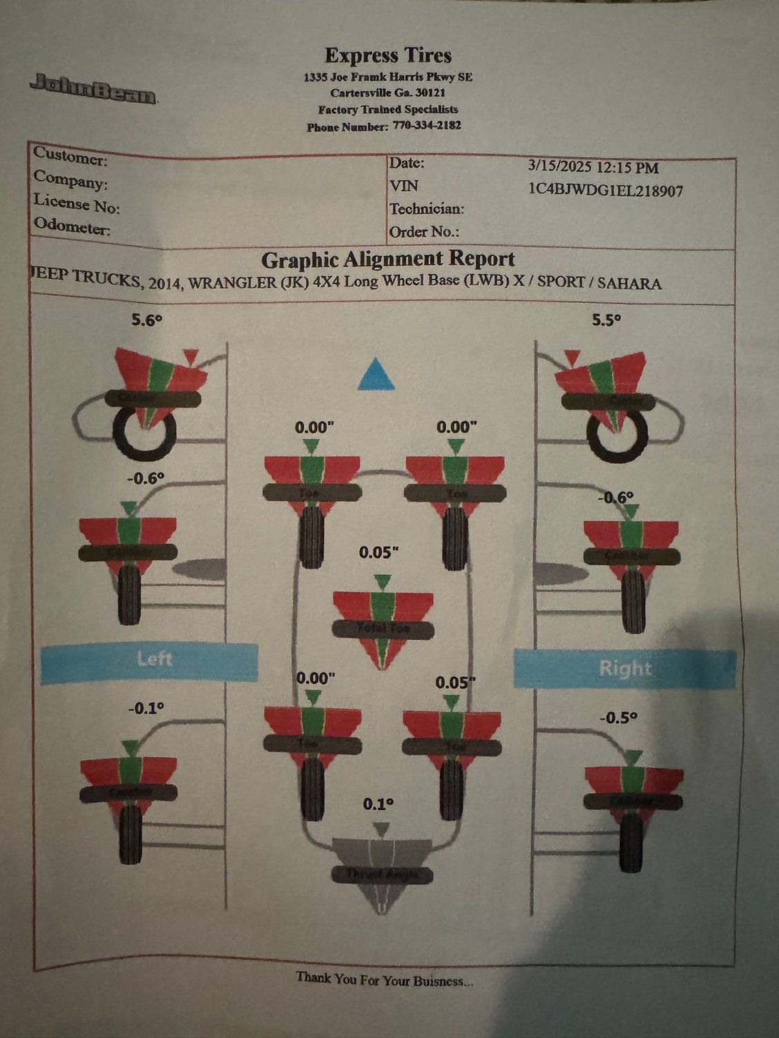

I had 2014 Jeep JKU - completely stock, and I installed a 3 inch lift kit and 35 inch tires roughly 700 miles ago.
Since then, the Jeep shakes at highway speed and sometimes during sudden acceleration.
I have replaced all control arms to adjustable ones from Clayton.
I have front and rear adjustable track bars.
I also balanced tires twice since and got the Jeep aligned although the shop said there wasn’t anything they could have done because I already aligned it pretty good?
Because I installed the lift kit and tires at the same time, I have no idea what is causing this vibration issue.
Maybe I should try balancing tires again?
DS went bad all of a sudden after lifting it?
Does anyone have any advice or tips on how to diagnose it or approach this issue?

Your caster on that alignment is pretty high, which is opposite of most people's issues. That factory front axle has a built in caster of 4.2°, and you are at 5.6°, which means your pinion is actually pointing downward by 1.4°, which would be pretty rough on a factory driveshaft that is now having to deal with increased separation from the transfer case by 3". If you remove the front driveshaft, how does the jeep drive?
Most of us lifted folks would run caster in that 4-5° range. there's no exact science really to perfect caster, it's more a range. you're really wanting to achieve acceptable steering without going to high that you introduce driveline vibes.
